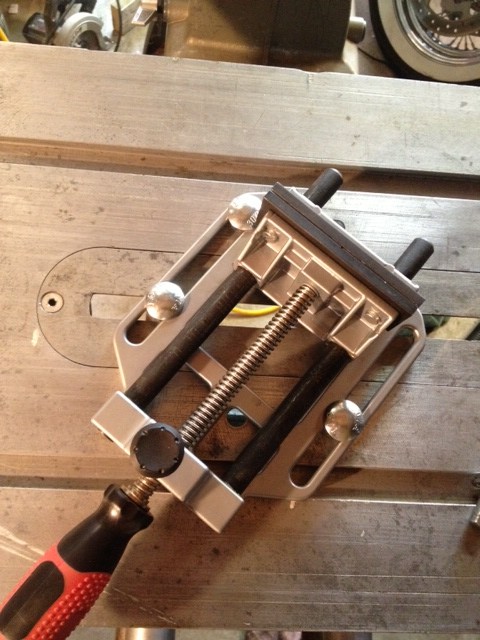

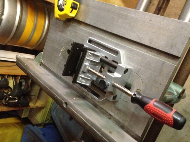

Well, my new SS drill press vise arrived today, and it has two flat mounting bolts designed to grip the slots in newer model saw tables. Not enough meat on the casting to accommodate cutting slots in the miter gauge grooves, so I need to drill four holes through which to run bolts to affix the vise to the table. If they are chamfered and bored straight, I don't see a problem with doing this. HOwever, I am new to the SS world, and I would like to hear some opinions and ideas regarding how to best approach this issue. One idea I have is to find a rigid metal disc to which I can mount the vise, in which are some curved slots near the edge, through which I can run some wing nuts, which would give me full 360˚ versatility on the vise angle. Whattaya think? Pic attached.

Look at the SS site for a fixture that looks like it can be easily reproduced.

Wait a minute! I can bolt it to the saw blade groove. I can raise and lower the table to move the vise. Thanks!

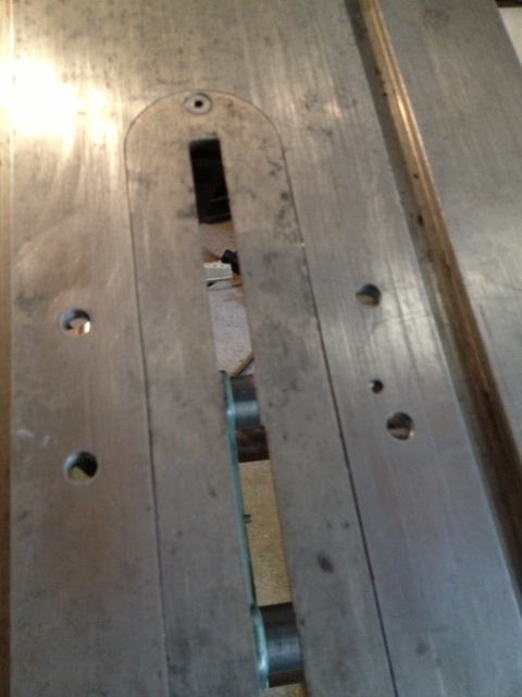

Butchery of old saw table

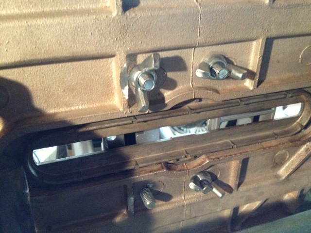

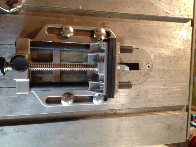

Well, I now have a super strong mounting setup for my vise. 7/16" carriage bolts fit snugly in the vise slots ( I had to dig through the bolts to find four that actually fit all the way in), and wing nuts under the table tighten it up quickly.
I have to drill a 3/4" broken dowel out of a piano bench leg, and I need to mount the jaws parallel to the quill movement. I offset the holes a bit to allow me to drill the center of a workpiece from 1/2" wide to the full width of the vise jaws. The vise slides back and forth to accommodate this. The part I drilled is thicker than the rest of the table, and there are gussets right there, two of which I had to modify slightly. It is a sturdy casting, and I think it will be just fine. It won't affect any other function I can think of.

The little hole was already there, having been provided by a previous owner.

I suppose I could have done this for the price of a couple of miter gauge slide bars, but I will be drilling in broken-off end grain hardwood, and there may well be some irregular stresses and bouncing on the piece from the drill bit hitting it, and I figure there is no room for error, so I went for what I thought was the absolute sturdiest configuration.
