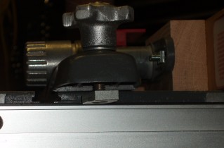

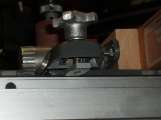

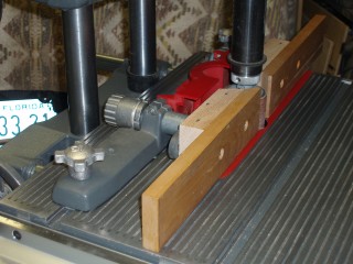

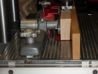

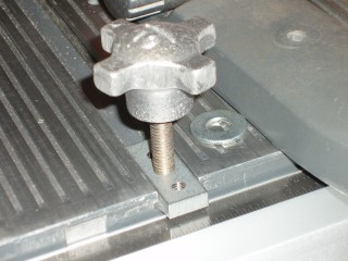

I use my father's shaper fence on my 520. I found that I can mount it with no modificatioins to my table:) . I use the miter tracks and 2 "55916" and threaded knobs to mount the fence assembly to the table. The only modification I did was make 2 spacer blocks to push out the wood fence face 1.25 inch from it's original position. This makes up for the difference in location from the mounting hole to the miter track. The blocks are easy to remove if I need to put the fence back on his 500.

I have seen your photos. Very creative solution.albie wrote:I use my father's shaper fence on my 520. I found that I can mount it with no modificatioins to my table:) . I use the miter tracks and 2 "55916" and threaded knobs to mount the fence assembly to the table. The only modification I did was make 2 spacer blocks to push out the wood fence face 1.25 inch from it's original position. This makes up for the difference in location from the mounting hole to the miter track. The blocks are easy to remove if I need to put the fence back on his 500.
I will add photos.
Al B
I would like to make one observation, however. It appears to me that when you tighten down the knobs to secure the fence in position on the table that you are screwing down onto the bottom of the miter track. I suspect that this will leave some gawling that you might now want.
Using a fender washer on that bolt, positioned above the table, with a spacer between the washer and the bottom of the knob, will eliminate that tendency. The bolt could be cut off to eliminate the need for the spacer.
Rather than screwing down onto the miter track, this method works by pulling up on the miter nut and squeezing the miter track between the knob and the washer. No more marks on the table.
I have a miter track that is really dinged up from having done what you have pictured.
I have become anal about marking up my tables, especially if it can be avoided.

I do not like to damage any of my aluminum surfaces, so the knob is only long enough to thread into the miter track nut. I do use a fender washer to displace the force of the nut on the top of the aluminum fence assembly. These knobs are a bit clunky, being large, but they work quite nicely. One could easily use ¼-20 threadded knobs in to the same nuts.
