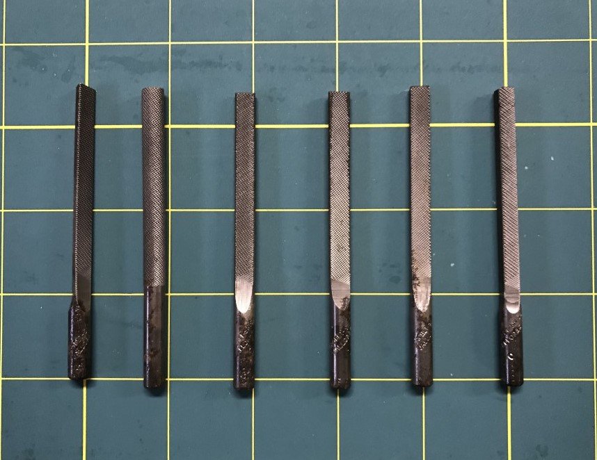

I may be late to the party on this, but found these for $16.00 and it looks like they ship direct from Falcon Tool. https://www.falcontool.com/PublicStore/ ... 7,183.aspx
The 3300 series on here Cuts on Downward Stroke · 1/4" Round Shank · 2-1/4" Cut Length · 3-1/4" Overall Length - these dimensions match exactly what was in an earlier post. Am I barking up the right tree here, or is there a different source that people have tried?
Shopsmith Power Pro Mark 7, Sawsmith 2000, Planer, Bandsaw, Belt Sander, Strip Sander, Jig Saw, Biscuit Joiner, Joint-Matic, Jointer, Mortise, Molder, Maxi Clamp, Scroll Saw, Shaper, Router, DC3300, Smithy Super Shop, Craftsman RAS & Bandsaw
Posts: 4232
Re: file set for old jig saw
The 3300 series files look like they are the same overall size as the Shopsmith Jig Saw Files so they should work as a replacement. The original files were sold as a set of six. Later 5 files were sold individually. The set of six files are shown in the picture below.
Jig Saw Files.jpg (99.31 KiB) Viewed 12564 times
