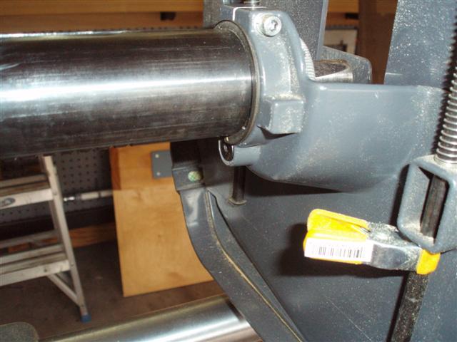

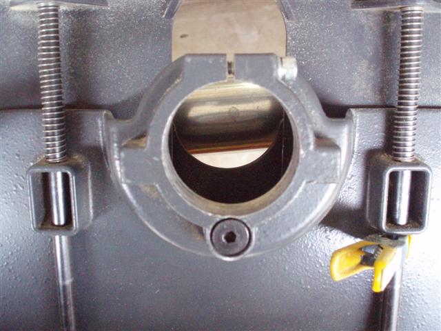

If you have a 505/510/520 and you are utilizing a lower saw guard, the riving knife is mounted in that saw guard. The position of the riving knife, with respect to the blade, is a function of how far onto the shaft the lower saw guard is mounted.
The riving knife adjustment is simply a screw that is adjusted so as to allow the lower saw guard to go onto that quill shaft just so far.
[ATTACH]25055[/ATTACH]
[ATTACH]25056[/ATTACH]

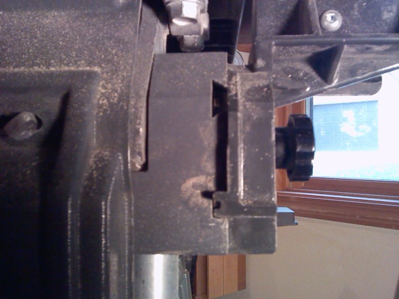

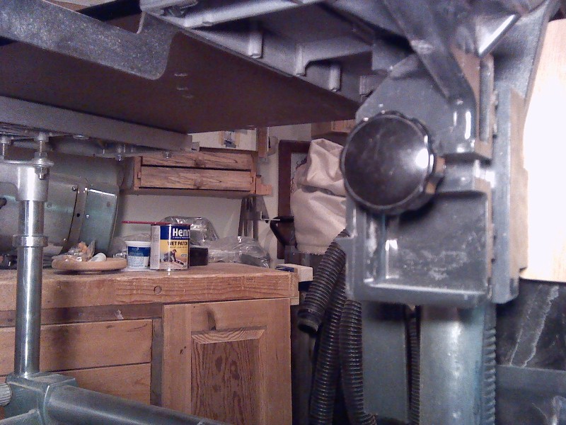

JPG40504 wrote:Any one out there have a 500 version for 'examination'?
Here are a couple of views of the splitter adjustment on my 500. As has already been noted, the 500 has a splitter attached to the upper guard while the other models have a riving knife. No vertical adjustment possible on the splitting knife.
- end view splitter adjustment.jpg (98.17 KiB) Viewed 2423 times
- splitter adjustment - view of knob side.jpg (140.21 KiB) Viewed 2423 times

sorry about this second posting of the same images...I just wanted to see if I could figure out how to insert them in the reply instead of attaching them.
- end view splitter adjustment.jpg (98.17 KiB) Viewed 2389 times
- splitter adjustment - view of knob side.jpg (140.21 KiB) Viewed 2388 times
