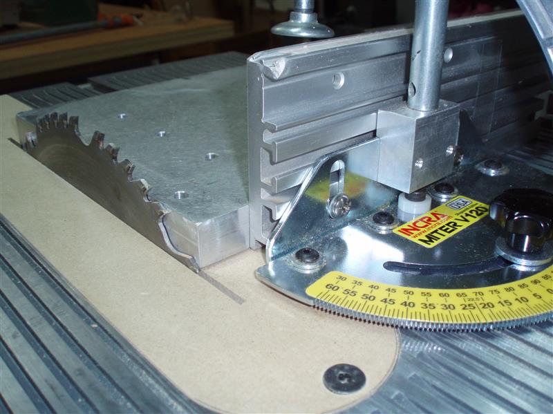

I believe I probably have something other that the "old miter gauge clamp" but I would sure like to know for sure. Why? Because my Safety Grip (though it has been moved to my Incra V120 Miter Gauge) seems to be very loose. It seems as though it was more rigid and held together than it is now.
Is there some sort of upgrade that I should have?

Locktiting the set sounds like a good idea. The old clamp always seemed a bit more work to use than I wanted, so hardly used it myself.
