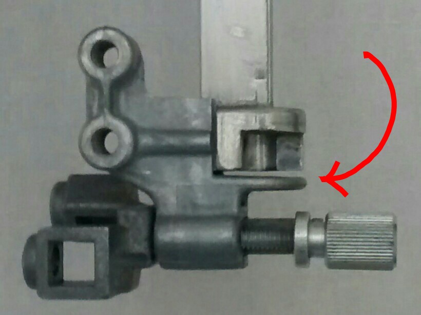

I've drilled and tapped the upper guide post bracket and added the nylon bolt. I had to flatten the sides of the slide post too because it was uneven but now it is much much easier to tune. The po had rather mangled the slide post already with a file. Long gouges from filing aluminum with a gunned up file. Can't tell what he was trying to fix.
I've also filled down the past at the base of the post that holds the guide blocks and bearings to increase the resaw capacity.
One question: I think the home on post was drilled too low. There is a big space at the bottom of the post (see photo). Do your saws have a space there? Anyone willing to measure where the hole is drilled in the sliding post and the past that holds the guide blocks? I'd like to see which was drilled wrong. If the post, I'll replace it. That will make it safer to file off a bit more for resaw clearance. As it is I'm afraid to make it wobbly. Do I need the capacity? Not now, I'm just having fun running the saw up.

Off hand it looks excessive. Has the PO been filing here as well? What is the 'height' of the part just above the gap?

I looked and yeah, it looks like it was filed down. What is odd is how worn the whole post is, especially on the surfaces that are hidden by the part that the bearing and guide blocks attach to. The whole thing has rather random filing marks but looks like it was worn smooth over time after that. Who knows - it had a few decades to get this way. I'll replace it if needed at some point but for now it is working with the extra clearance and the nylon bolt added.
Thanks for all the help.
