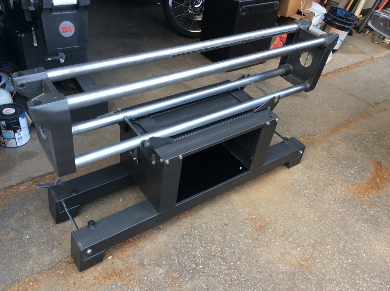

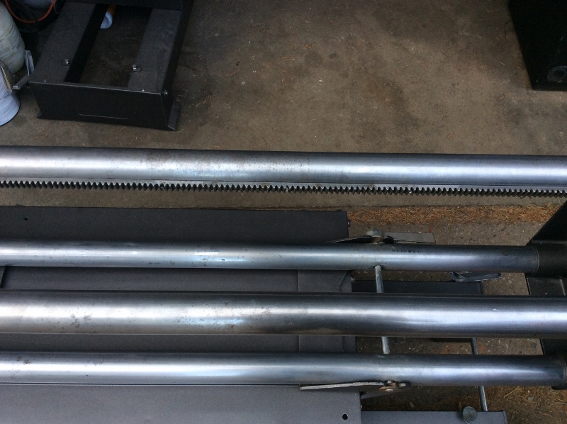

I've tackled the base for the Mark VII...repainted it, cleaned the wheels, way bars and installed the new metal gear rack. I put the headstock on it and ran it back and forth and it works like new. I also added a steel plate in the vacuum box. Next on the list is all new bearings and paint for the headstock. The belts look good but if I can find new ones, I'd like to replace those while I have it apart.

A Mark 5/V poly-v belt will work(9 ribs). I have not located a source for a 13 rib poly-v belt of the proper length. I assume you already know of my experience with the motor belt. 30 1/2" length, but those available are too narrow. It almost gives the correct speed range(too fast). The belt and sheaves do a balancing act.
Interesting vertical rest screws! Elevator bolts, or rubber bumpers? <<<< Nev mind, just read the other post/thread.
Nice looking base!!!!!!!!!!!!!!!!!!!!!
