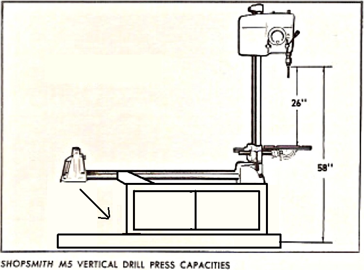

From your latest pix, I think you are wanting to mount a Mark 5/V way/bench tubes and end caps on a 'bench' and use the 'normal' pivot for drill press use, but add the ability to tilt the other direction for under table shaping etc. that pivots similar to the MVII that places the headstock and table lower. That would mean a short 'bench' with pivots like a MVII on the end opposite the 'normal' M5/V pivot.
I think that could be done(IIUC), but the release for the 'normal' pivot end would would need to be created. The Mark 7 end cap does that. A Mark 5/V end cap can be modified similarly(done that already;)). A Mark VII type pivot/catch need be created for the other end.

beatnik wrote:I get the idea this hasn't been discussed ? Surely someone has done this. What I'm thinking is a base something like this, but the cabinet goes fully to the end on the drill press side. This way it's good on height on both ends. Low on the left for under table and tall on the right for over table.
Using Google you can search books which will pull up the old archives on Popular Mechanics. I believe the full article was available for building a Mark VII type stand in place of the legs on a Mark V. With the tilt you ended up tubes much closer to the ground like a Mark VII. Unfortunately, I'm having no luck finding it today, but I know I read it a couple of years ago. You'll find searching through Google Books a little bit of a challenge because Shopsmith also bought ads in those publications.
In fact, I think this picture is from that article.

I don't think reversing would be necessary, I use shapers every day and feed material from right to left. In my head this would not change ? I've attatched a crude drawing of what I'm thinking of.
I don't know all the ins and outs of table/fence adjustments on the SS.

That is 'like' I understood.(sorta:D) I like yours better. You could possibly use MVII bench tubes and MVII pivot brackets(for the 'left' end), but the tubes are 3/4" shorter(52") than Mark 5/V ones(52 3/4") which I think is not a severe problem. May need to insure proper positioning under the clamps. Realize that would be a weakness compared to the MVII which had captive bores for the tubes.
As for your daily shaping, move the fence to the other side of the cutter and then reconsider the 'need'. And yes there is need for inverting the cutter(ask Charlese:D).
Beware!:eek: Over exposure to things makes one assume commonality with things slightly altered which is not always a prudent/correct action.;)
I think the easiest way to 'solve' the table post orientation is to get a second M5/V table and reverse the posts(places gear teeth on opposite side).:)

If I did this I would have measure exactly where the MVII tubes pivot hole would be and if that would work. Also if the brackets fit between or outside on the V lower tubes.
