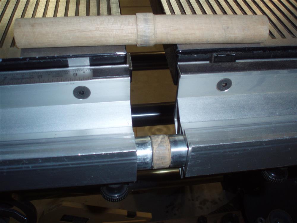

I do not have a Wonder Fence (wish I did) but I think I can relate. Finding that you have to change table height after you are all set up with extension tables attached can be frustrating.
The extension tubes almost have to be removed in order to do this. Well, maybe they don't have to be "removed" but the extension tables need to be disconnected from the Main Table.
To make this easier (for me) I have created a coupling that I use to tie the Main Table Extension Tube to the Extension Table Extension Tube. Loosen the extension tube, pull it away, make the adjustments and reconnect the extension tube.

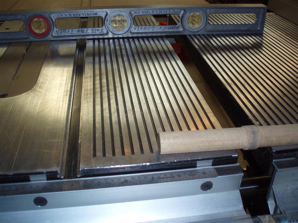

I have an old Stanley level nearby that I use to check table height. It has lost its ability to function as a level but it is a good straight edge.

I tend to use this only on the front rail unless I think I need extra table stability. Using this has made my 5' extension tubes into an ornament on the wall.
