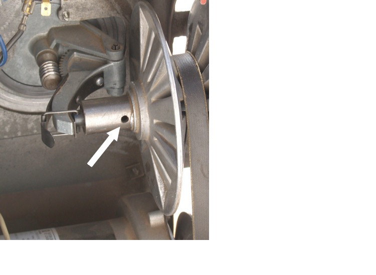

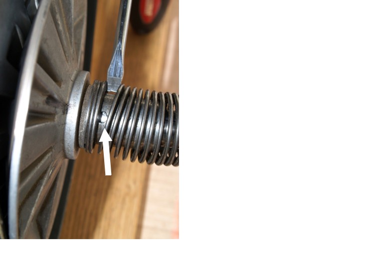

If the motor is bogging down, the voltage is dropping! That is a forgone conclusion.
As recommended, I would deep six the extension cord and plug the Shopsmith into and outlet that you know is not being used by any other appliance (a dedicated circuit for the Shopsmith).
Then lubricate everything and try again.
Oil it here:
[ATTACH]25525[/ATTACH]
and here:
[ATTACH]25526[/ATTACH]
Then if you still have a bogging down, set the speed to saw range and just let the Shopsmith run awhile to loosen up the belts.
NOTE: You are using a sharp blade when doing the cutting and it is the correct blade (crosscut or rip), we all ASSUME that.
These are not my photo images. They were posted some time back by Nick.
- Sheave Lubrication, Lower.jpg (38.63 KiB) Viewed 1116 times
- Sheave Lubrication, Upper.jpg (46.03 KiB) Viewed 1115 times
