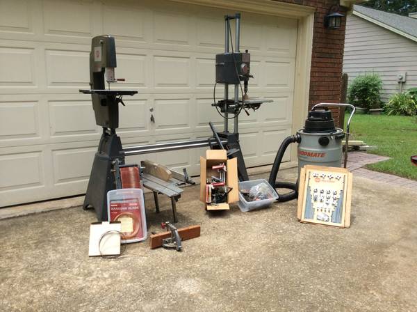

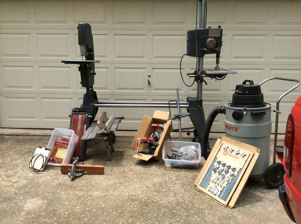

There are several items for sale here that I do not recognize. What is in the box? It looks like a vise of some kind. Is the item on the far right box a clamp? What are all the white panels? Two tables?
Robert Keeney
Tallahassee Florida USA
I am guessing but I believe the while panels are custom tables. The one leaning on the DC is a sliding cross cut sled. The one with the long, narrow cutout appears to be for the jointer. The one on the left is a router table. The box of stuff leaning on the Shopmate (a dust collector by Shopsmith) is a set of MaxiClamps (I believe). The smaller box appears to contain, amongst other things, is a Zliss vise. The Zliss is a very versatile, relocatable vise. I wish I had a couple more.
PS: I think I see a lathe duplicator leaning against the drill press.
It all appears to be in very good condition.

It looks to have a front table extension too.
The contents of that plastic tote could also be "interesting". :)

It appears as though there is a Zyliss style vise in the box. There is a Maxi Clamp system laid out to the right of the pictures that show the vise. The other tables are an outfeed table, a crosscut table and an overarm router table (though I do not see the router arm in any of the pictures).
Rob in San Diego
More lathe duplicator parts in de 'interesting' plastic box.
The listing does mention an over arm router.
What are you waiting for? A first hand look and conversation will reveal those answers and more.;)
The light gray part(s) have me wondering whatis.

Your picture looks to have the aforementioned lathe duplicator support arms and channel.
Rob in San Diego
SDSSmith wrote:Your picture looks to have the aforementioned lathe duplicator support arms and channel.
Closer look at the 'top' pic (side view) reveals that. Thanks! I just was not seeing the 'details' in the second pix. I recognized the black colored arm in the back but not the lighter appearing parts nor did I percieve them as more than one 'part'.
