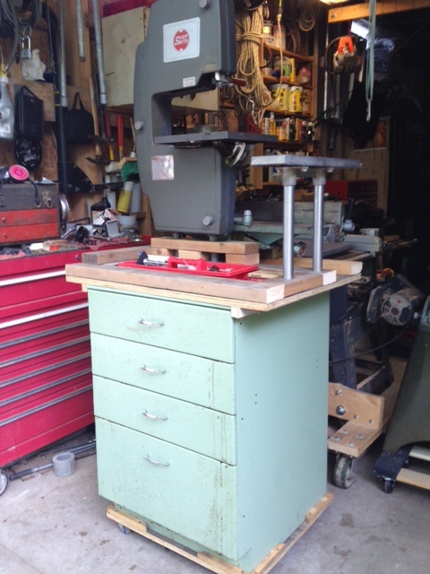

I'd be more inclined to look for a deal on a newer machine, as anything from SS is very costly. However, if it is what you want, then that's what you get. I bought a new Harley a few years back, and I didn't quibble about it.
I'm just happy to have found my greenie, and then a bandsaw attachment. It all fits on this cart now, and I am NOT going to start accumulating a ton of new stuff, but I do relate to those who are into doing that. I relate to that in a big way, which is why I am resisting........;)
Accessory Cart.jpg (111.45 KiB) Viewed 1304 times
