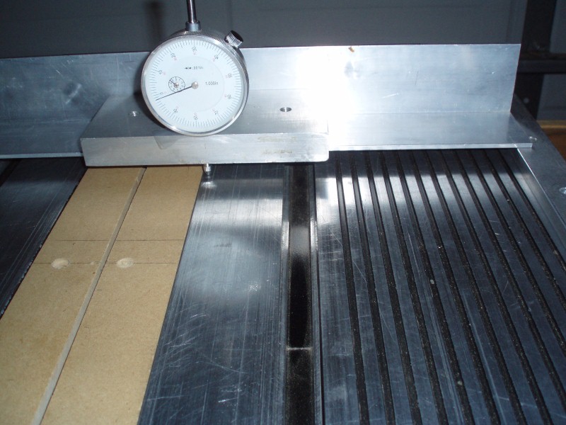

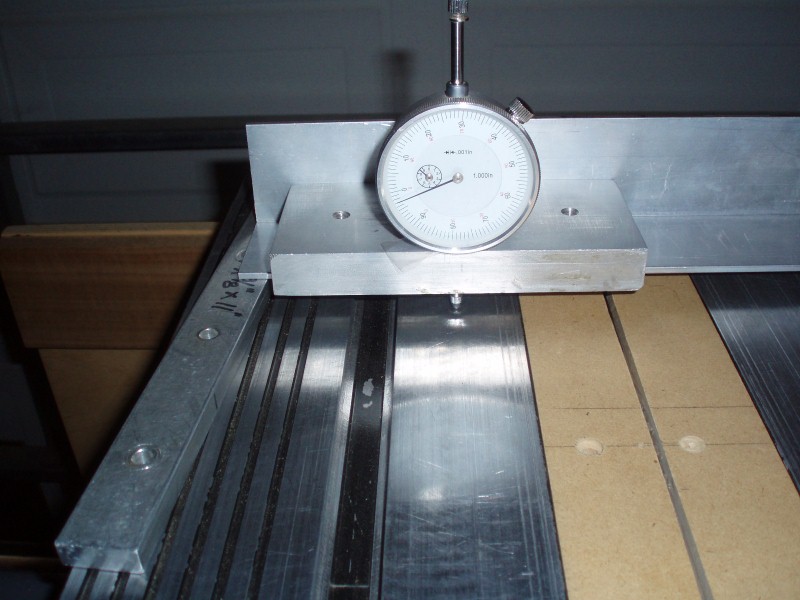

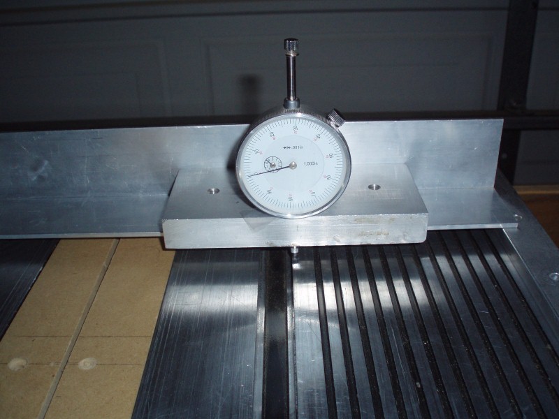

Why Will This Not Work?
Needs to be refined but it does work!
[ATTACH]25934[/ATTACH]
[ATTACH]25935[/ATTACH]
[ATTACH]25936[/ATTACH]
This is really a take off on a suggestion by JPG --post #11 this thread.
- Checking Table Flatness_Concept 2 003 (Custom).jpg (101.54 KiB) Viewed 5515 times
- Checking Table Flatness_Concept 2 005 (Custom).jpg (117.25 KiB) Viewed 5517 times
- Checking Table Flatness_Concept 2 008 (Custom).jpg (100.71 KiB) Viewed 5517 times
