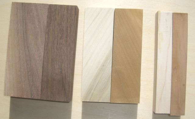

Left to right: Walnut, Poplar, Maple.
Untreated on the left of each treated sample.
Crappy camera. The poplar's untreated piece didn't show it's contrast between the light and dark. But, there is quite a contrast.
[ATTACH]25967[/ATTACH]
Serendipity?
