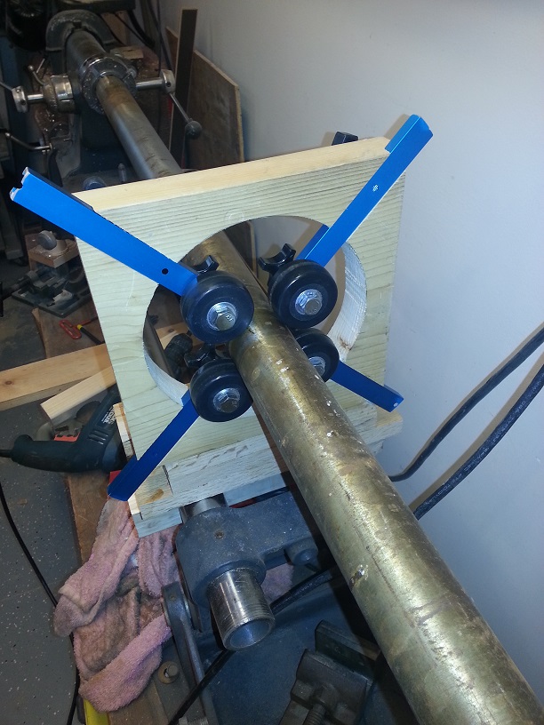

I have used this method two times, works great and is fast. Here are the plans I used. I wish I had used the roller blade wheel, but I used what I had. I use this method to clean the tubes too. [ATTACH]25976[/ATTACH]
[ATTACH]25974[/ATTACH] [ATTACH]25975[/ATTACH]
- Cutoff tool.jpg (24.58 KiB) Viewed 2599 times
- lathe steady rest.jpg (175.29 KiB) Viewed 2600 times
Lathe Steady Rest.pdf- (648.95 KiB) Downloaded 2425 times
Joe

Thanks guys, for got about a cut off wheel on a hand grinder, did not think the sawsall would be up to it even with the right blades, may not be straight enough. I have both. I am guessing the way that they go into there appropriate fixtures, they dont have to be perfectly square at the ends???

joedw00,
what kinda chuck is that on the ER in your pic? I would appreciate more info on it please.
