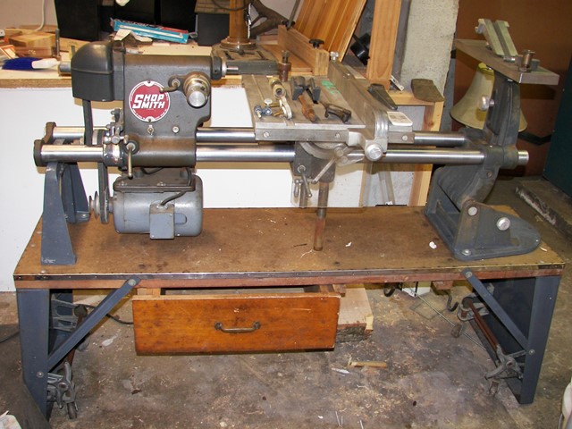

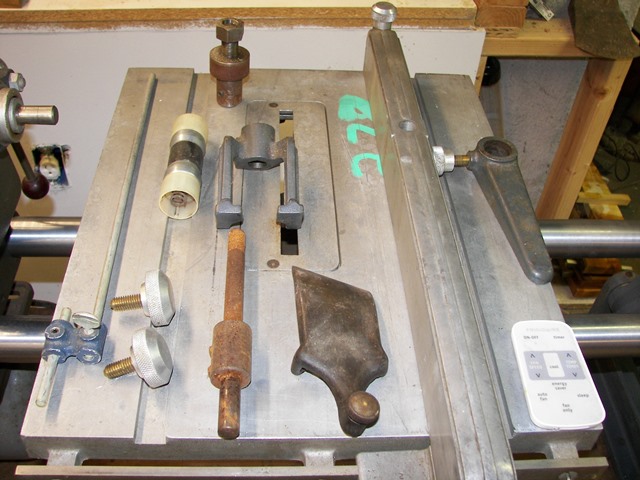

As promised, pics of my new to me 10 ER!
- 100_1391.JPG (104.47 KiB) Viewed 9995 times
- 100_1393.JPG (92.05 KiB) Viewed 9990 times
- 100_1394.JPG (83.79 KiB) Viewed 9988 times
- 100_1395.JPG (97.48 KiB) Viewed 9987 times
- 100_1400.JPG (96.5 KiB) Viewed 9990 times

No such luck.SDSSmith wrote:Nice looking machine. I see that you have the special headstock pulley with integral drive hub. Did you receive the 'A' or 'B' power mount adapter brackets with the machine?

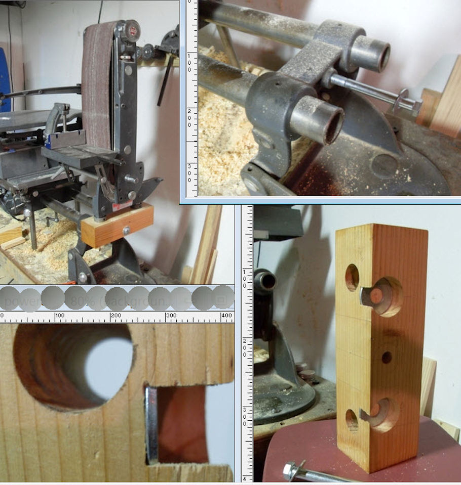

I like this one that Shipwright 'inherited'.
[ATTACH]26070[/ATTACH]
- 10ER SPT Mount als shipwright.JPG (188.24 KiB) Viewed 10044 times

Very interesting! Any other views of this available? Better yet, any plans? I had not intended to mount anything to this one, but maybe if I put the bandsaw there I could leave the belt sander on the mini.

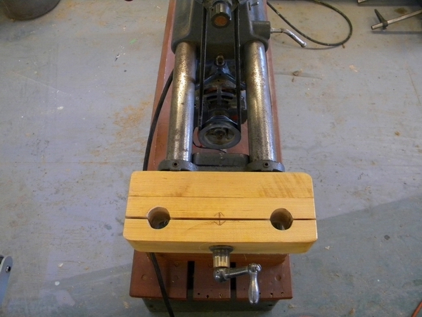

Not Shipwrights but similar:
[ATTACH]26078[/ATTACH]
Would work better if split on the center line of the two through holes to grip the SPT's posts, like Shipwrights.
Apologies and thanks to the unknown maker.
- 10ER power mount.jpg (155.48 KiB) Viewed 10008 times
