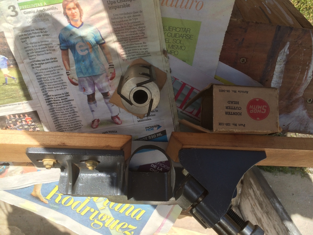

As I mentioned in Community I did get a couple of 10ERs and I have some questions regarding configuration and maintenance.
1) I got a jointer fence and head but I am unsure how to attache the head to the 10ER. The photo below shows what I got, if anybody can enlighten me on how to attach to the 10ER quill and table, much appreciated.

eartigas wrote:Thanks. It all start to make sense now. I just realized the jointer head has additional set screws that are probably to hold it to the ER quill. I'll try tonight : ))
Now I also see why the strange shape it has that as you say would fit in the table insert.
Perhaps this will 'help'.
[ATTACH]26156[/ATTACH]
[ATTACH]26157[/ATTACH]
10ER jointer-shaper 1.pdf- (661.31 KiB) Downloaded 626 times
10ER jointer-shaper 2.pdf- (813.8 KiB) Downloaded 649 times
