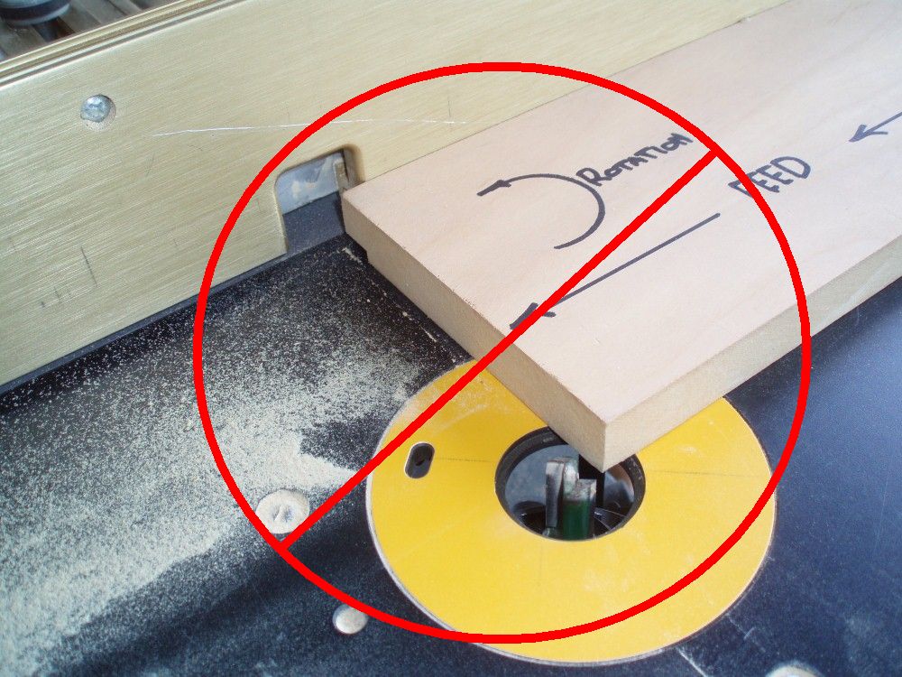

I did not do this (recently) but I have done it and I was all set up to do it again. DO NOT trap the work piece between the cutter head (router bit) and the fence. DO NOT.
[ATTACH]26194[/ATTACH]
DO NOT do this. The work piece will almost certainly be propelled off the table to the left.
A rabbet must be cut with no wood between the cutter and the fence. DO NOT trap the work piece between the cutter head (router bit) and the fence.

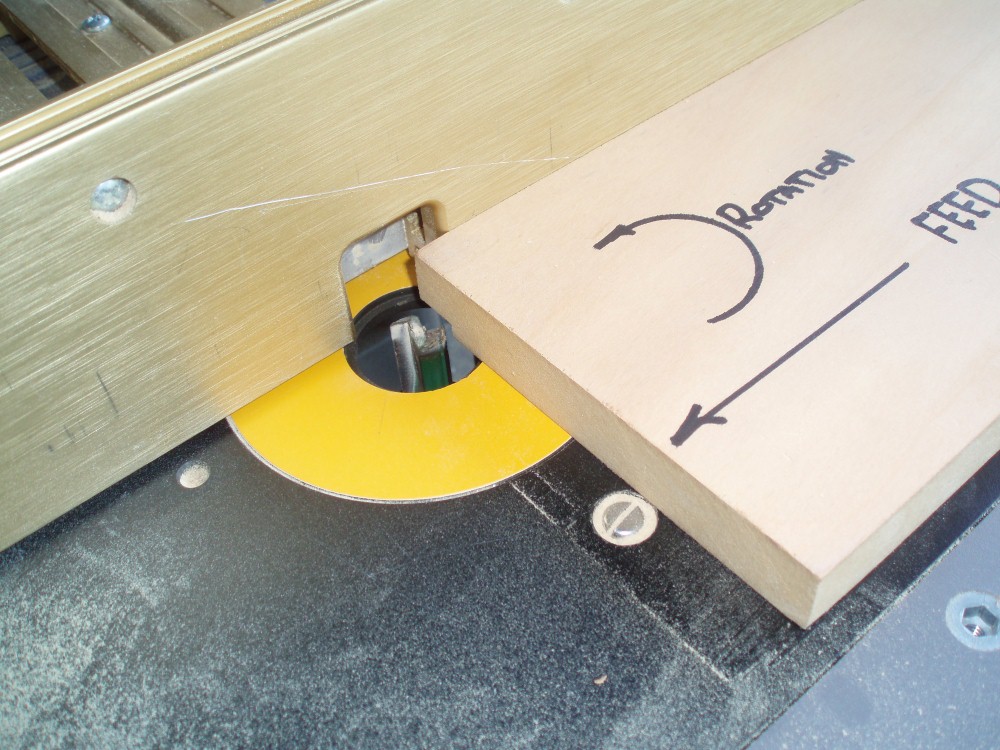

The Safe Way to Cut a Rabbet.

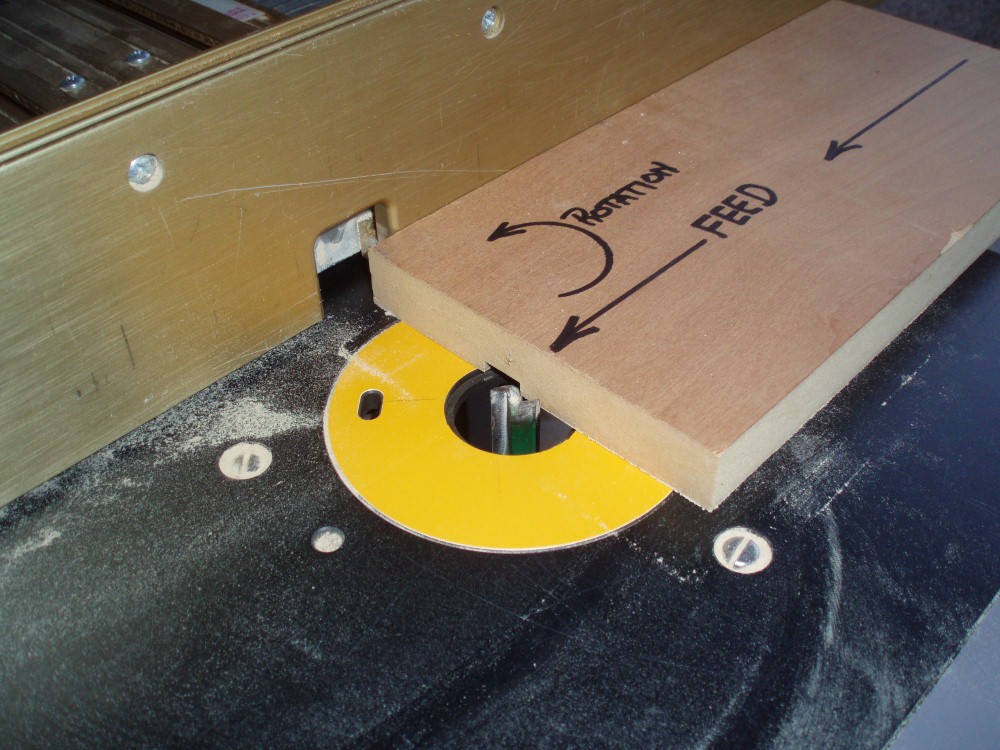

The same advice is given for widening a dado that has already been cut. To widen a dado, don't do this.
[ATTACH]26196[/ATTACH]

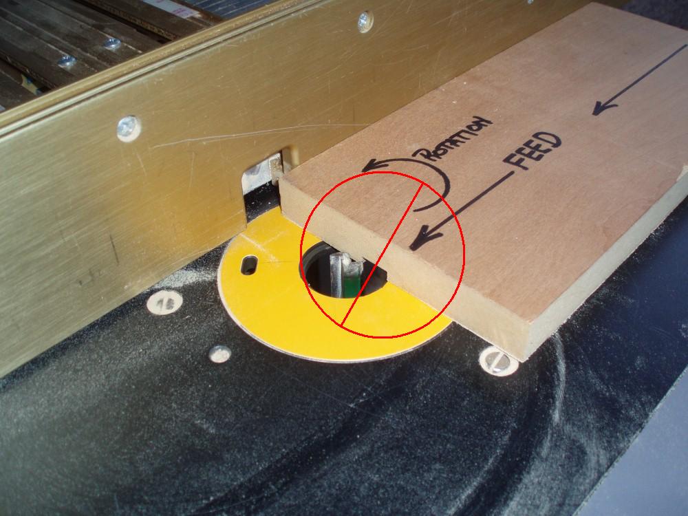

[ATTACH]26198[/ATTACH]
Do This Instead. Notice that there is no wood between the cutter and the fence.
[ATTACH]26195[/ATTACH]

- To Cut a Rabbett_Don't Do This (Custom).jpg (115.15 KiB) Viewed 8530 times
- To Cut a Rabbett_Do This (Custom).jpg (199.87 KiB) Viewed 8631 times
- To Widen a Dado_Don't Do This (Custom).jpg (103.68 KiB) Viewed 8528 times
- To Widen a Dado_Do This (Custom).jpg (199.4 KiB) Viewed 8636 times

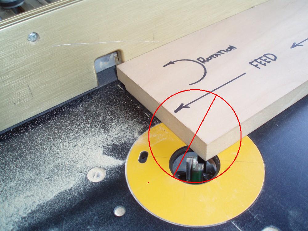

Always good to review the correct way to do things before you get yourself in touble.
I do have one sugjestion, on images show the WRONG way of doing something it is advisible to put a circle with a slash through it in say red. That way it is clear that this is the wrong way.
This would be an example:
[ATTACH]26202[/ATTACH]
To me it just makes it more clear that this picture shows the wrong way to do the operation.
- To Cut a Rabbett_Don't Do This (Mod).jpg (152.61 KiB) Viewed 8552 times
