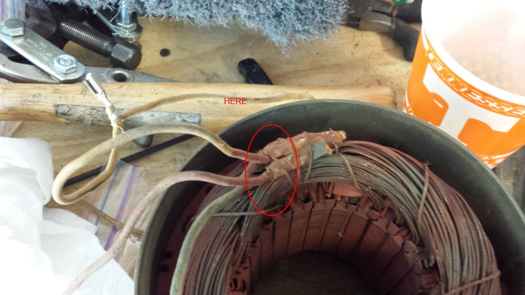

Hello all,
Please see attached picture.
Please give advice on what you would do, if anything, to the wiring where they meet the winding connections. The wires are a little loose and fear breakage based on age after all is re-built and in working order.
Is it reasonable to take some liquid electric tape and add a little on top or around the connection point(s)?
Thanks for your help.

The insulation appears to be in good condition. A small plastic zip strip cable tie will secure it. I assume you do not have lacing twine!:D

Yes it is. It's the actual wire where it goes into the winding connection I'm worried about.
I'll look at your suggestion and no I do have any lacing twine handy.
The wires have some open insulation along the length.
I am fixing that.
