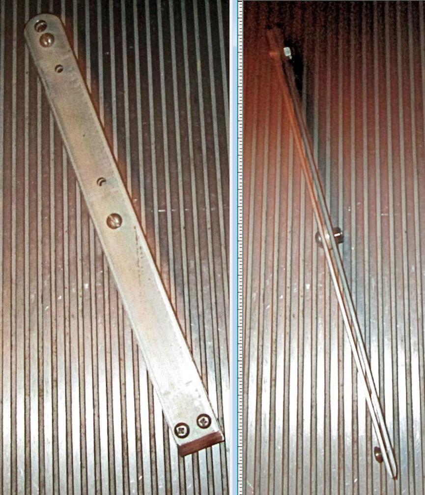

No, but I have sharpened knives on the strip sander - see "Sawdust Session" #10. http://www.shopsmithacademy.com/SS_Arch ... _Index.htmrb61 wrote:I have an interest in knife making. My first step would be simple stock removal done on a belt sander. From a factory, these devices can be very expensive. It struck me that they are simply an electric motor with a pulley set up to route the belts, with a tool rest for the piece being worked. I have a spare Shopsmith, and was wondering if anybody has ever seen a set up for using their Shopsmith head as a motor for a home made set up? I was thinking that I could cut the spare down into being a Mini setup and rig something to it. The ability to vary speeds, along with available gear reduction and increase assemblies seems like a match made in heaven.
Anybody here ever do this or know of somebody who has?
And the Shopsmith Academy shop Tips show the knife holding tool that you can make. Drawing and measurements are on the blackboard. http://www.shopsmithacademy.com/Tips_Ar ... Knives.htm
And one of these holds the knife holding tool right where you want it. http://www.shopsmithacademy.com/Tips_Ar ... Knives.htm

I use it a lot but have never made a knife with it. Sharpened a few with the holder charlese mentioned and it works great. Here is a pic of the holder:
