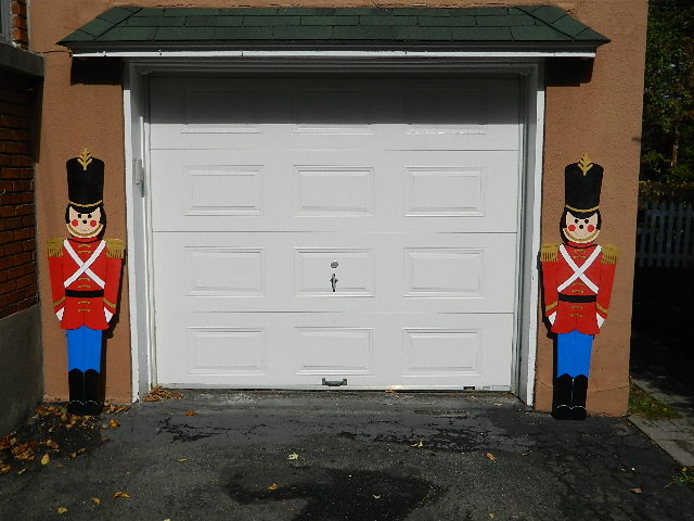

Here are my latest projects, requested by a bowling buddy of my dear wife. The original plans called for them to be 60" tall but after they were cut out, we decided that the legs weren't long enough. So that required making a couple more. I added 4" to the legs to give them more balance.
As usual, I did the cutting and lines, etc and dear wife did most of the painting. Hopefully the recipient will like them.
Now we will finish the original pair to use at our home.

- DSCN1008.JPG (123.72 KiB) Viewed 4806 times
John,
Very nice project. Is that their permanent location?
I think you got the leg length right.

'dear wife' out did herself. Those really really look good!!!

Outstanding!
The proportions are perfect!
Nicely done!

What kind of finish do you use so they will last in the elements?
They look awesome by the way, thanks for sharing!

First, thanks for the positive comments!
The picture was taken in front of my garage but I understand the person requesting the soldiers plans to mount them on either side of her garage door.
"Dear Wife" has taken over most of the painting on my outdoor and seasonal projects though I often have to give her a little advice, most of which she does not appreciate.
The finishing involves several processes.
For the flat project like this one, I use "select grade" 5/8" exterior plywood which has one good side. I fill all the holes or blemishes with wood filler and sand before any finish is applied.
Then a coat of alkyd or oil based primer is applied to both sides of the plywood panel. I finally learned to do this on the wood before cutting. This avoids going over all of the pattern again after the primer covers up the tracing lines. (Took me a long time to figure that one out).The edges are primed after cutting.
The back side is then given two coats of exterior latex enamel.
The pattern side is done with at least two coats of the appropriate colour in acrylic craft paint, including bringing the colour around the edges.
I then go over most of the lines with a fine tip permanent marker to highlight the various parts.
The finishing touch is at least two coats of exterior clear spray finish.
All my outdoor seasonal projects so far have lasted at least five years and with a little touch-up, as long as ten. Some of the summer ones that get more exposure to the weather last about three years before requiring touch-up or repairs.
Some of these look easy when looking at the pattern online or in a catalogue, but we are always surprised at how time consuming the project really is.
Now on to a couple of indoor lighted snowmen that another friend of my dear wife has requested.
John
