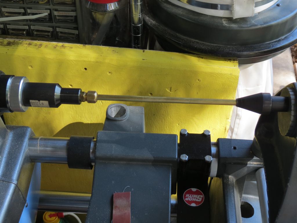

I start by mounting my turning parts to the shopsmith. Note the live pen center in the tailstock.
[ATTACH]26302[/ATTACH]

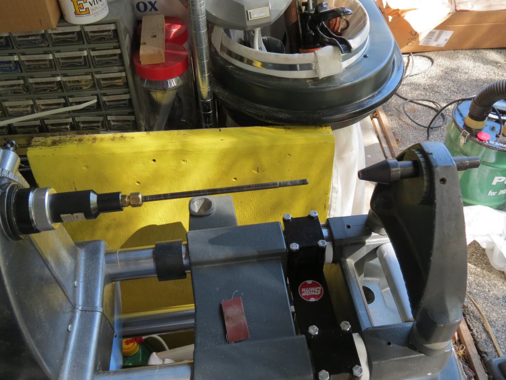

I can mount 3 barrels of this length at the same time. Use a light touch to tighten it doesn't take much to sand these.
[ATTACH]26303[/ATTACH]

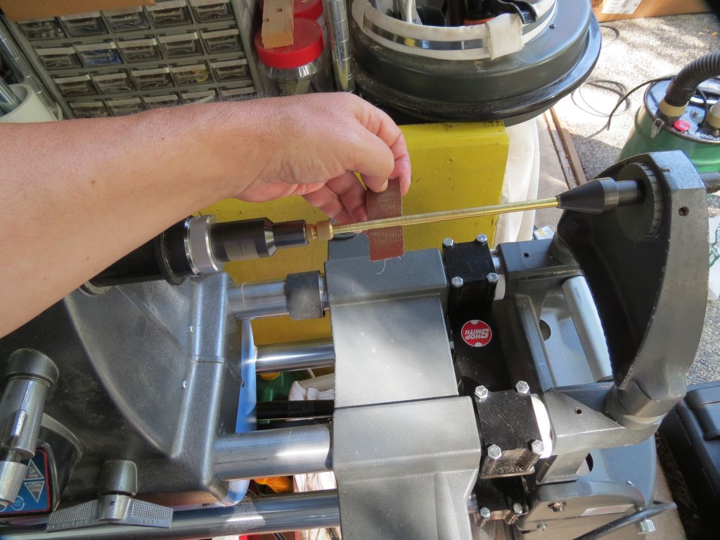

A small strip of sandpaper does a lot of barrels. Ignore hand position as it only to give you an idea of the process, reaching over is not a good thing.
[ATTACH]26304[/ATTACH]

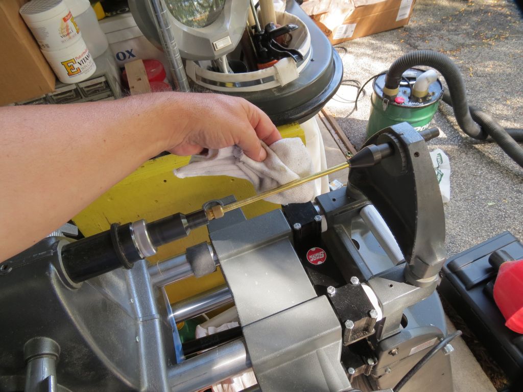

Again ignore the hand position but I do use a rag to clean up any sanding dust.

By location the headstock I can use the quill to hold them and then let it wind back so the tubes can be added or removed from that position.
This really goes fast and you don't get any brass stains on you fingers.

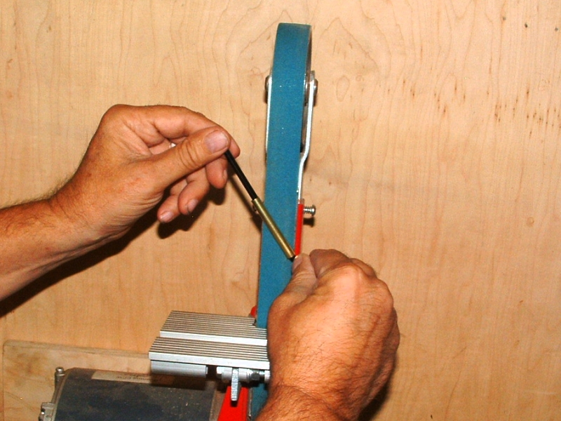

For scratching the pen tubes I have been using my strip sander and an Allen key for a holder.
[ATTACH]26404[/ATTACH]
Lightly touching the tube to the sanding belt for a second or two causes it to spin on the Allen key leaving diagonal scratches.

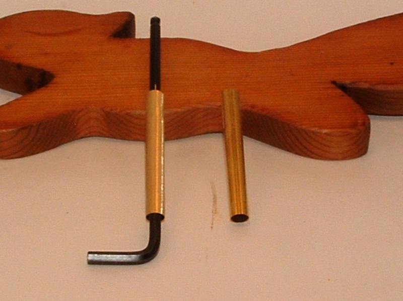

The tube on the left has been scratched. the one on the right has not.

I think this would work on a belt sander or a disk sander also.
