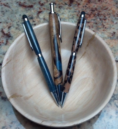

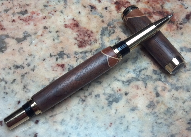

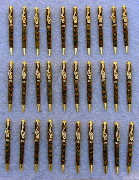

No noticeable difference between Mark V models when in lathe mode.
The Mark V is a serviceable lathe and can be made to make pens.
I've made hundreds. What do you want to know?
[ATTACH]26482[/ATTACH]
[ATTACH]26483[/ATTACH]
[ATTACH]26484[/ATTACH]

- 2012-12-17 07.12.40.jpg (110.49 KiB) Viewed 1985 times
- 2012-02-13_18-29-09_831.jpg (325.86 KiB) Viewed 1983 times
- All30GradPens2.png (709.07 KiB) Viewed 1983 times

Love the treble clef!
Nice pens!
