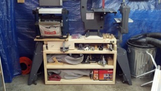

I have my lunchbox style planer firmly attached to one end of my mobile storage unit. As you can see the storage unit is a SS base unit. When I use the planer I just swing the end of the unit away from the wall and I'm good to go.
Shopsmith Tool Storage.JPG (26.56 KiB) Viewed 2854 times

Terryd very interesting setup.

Thanks. Needed a home for a lot of "stuff". Found some really good ideas on this Forum to fuel my imagination.
