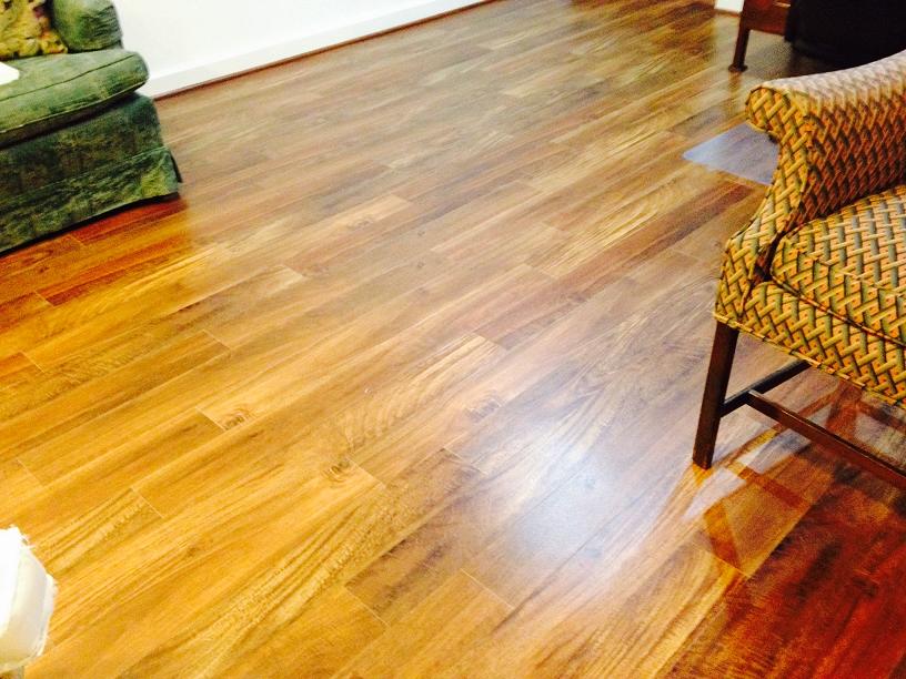

We had some engineered hardwood in a finished basement that got destroyed in the flood we had last winter when a pipe froze. We replace it with a vinyl "luxury plank" from Mannington called "Adura". It is a click floor. It is less than two months old but we like it so far. Here's a link to the product page:
http://www.mannington.com/Residential/Adura/DistinctivePlank/Acacia/ALP070.aspx
And here's a photo of part of my basement with the product installed.
[ATTACH]26639[/ATTACH]
