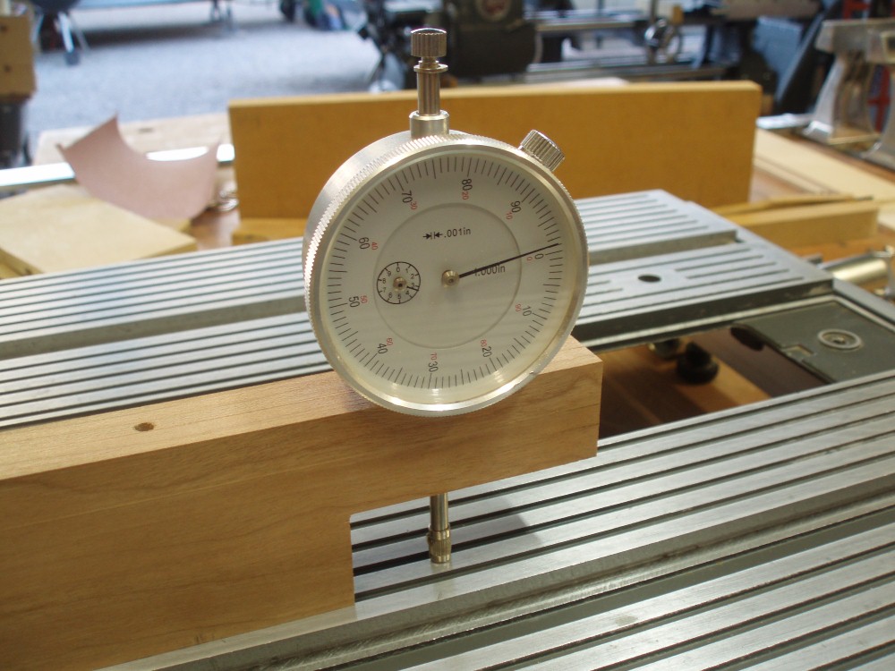

Interesting Phenomena (Jointer Table Flatness)
I have used my jointer for many years and have always been very satisfied with the performance. I still am.
But, as a result of this thread, I decided to start from scratch and check out my jointer. Some question have been asked (and even responded to by me) that have now peaked my curiosity.
If my measuring techniques are suitable for this task, my jointer tables are not flat. At least not as flat as I would have said.
[ATTACH]26675[/ATTACH]
There appears to be a shallow cup right in the center of my outfeed table and a low corner on the infeed table. The deviations are slight (.002" to .003" but more than I expected.
My flatness gauge is shown here being used on the Main Table but I use it for many different applications. On the jointer table, I can zero the gauge anywhere on the table but then when I move it around on the table(s), I see variations of .002" to .003".
- Checking Table Flatness 011 (Custom).jpg (173.13 KiB) Viewed 5440 times
