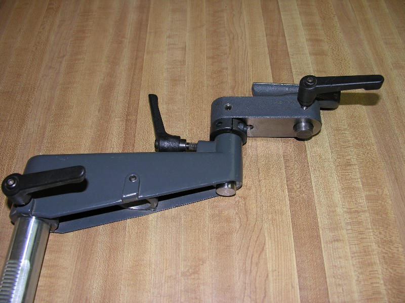

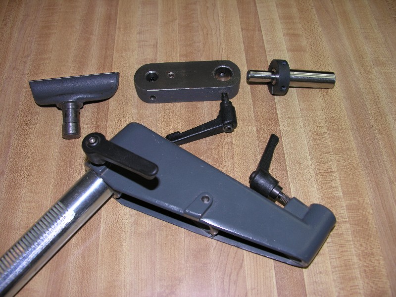

I have the universal tool rest and it is great, but sometimes I just need the standard tool rest with a bit more articulation to do a little turning job. I used the tool rest bar from the universal and draw filed a shaft to fit the standard tool rest. The power pro and a new file made quick work of the draw filing.
LDH
[ATTACH]26680[/ATTACH]
[ATTACH]26681[/ATTACH]

I am not quite sure what you are asking about. I slipped a power pro onto my 520 last year and found that I lost a bit of carriage travel with the lift assist that I added at the same time. I use a dual bearing mandrel saver from Vicmarc for pen turning and I was not able to get my tool rest where I needed it. The extra little arm gets me where I needed to be.
