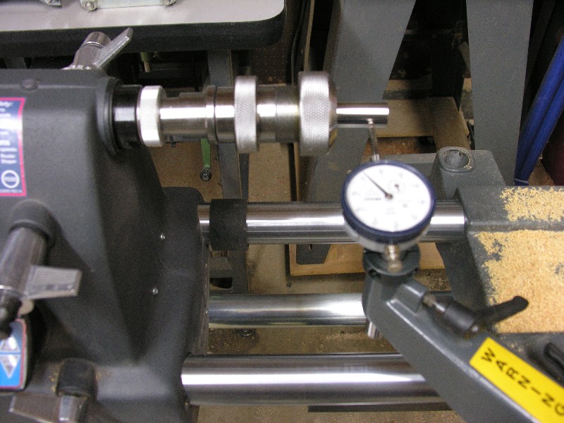

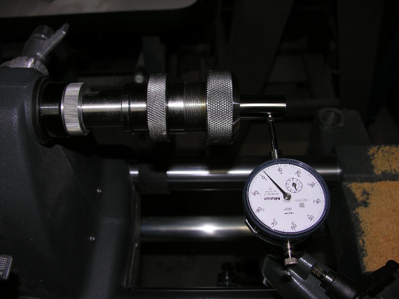

I received this PSI Collet Chuck a couple of days ago and decided to do a quick check on the run out. I thought the 5/8" spindle adapter to the 1x8 thread of the chuck might add more than acceptable run out to the setup, but I was pleasantly surprised to find the run out to be .002 and that is acceptable to me for what I do. The chuck and the ER 32 collets are quite reasonable in price. Your comments would be welcome.
