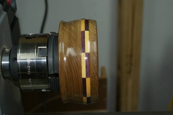

I have been interested in doing some segmented turning for a while and I do have the program from Bill Kandler. One critique that I have is that in my opinion is that he sometimes tries to make some of the rings too narrow for a beginner. Also a segmented project does not have to consist entirely of segments. Sometimes one segmented ring will enhance a project.
[ATTACH]27018[/ATTACH]

- bowl with ring one.jpg (70.29 KiB) Viewed 8413 times

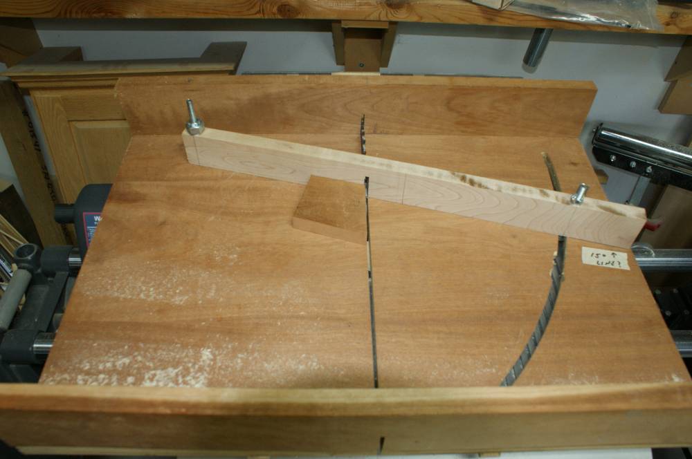

This may not be the slickest dissertation ever on this site but I will try to convey what mistakes I made during my learning curve.
First thing that you must do is build a sled. The sled can have a fixed angle, preferred by many folks, or you can build an adjustable one like I did.
[ATTACH]27020[/ATTACH]
This one is my first but has since been modified by adding a bolt to the rear fence that is adjusted to provide a stop when the moveable fence is at 90 deg to the blade. Just remember that ALL of the angle settings MUST be made with reference to the body of the blade. There is no requirement that the front and rear fences be exactly 90 deg to the blade. All cut angles are referenced from the moveable fence to the blade. The front and rear fences only serve to hold the sled body together Unless your fence is super accurate there will be errors. The stop bolt is set by making cuts across a scrap board and making sure that the cut is square and then lock down the bolt. After this is done you can mark the angles on the arc.
My preferred measurement for the angle setting is an Igaging 10" blade protractor. These instruments have an accuracy of .1 degree
To set the fence for the first cut I used a piece of scrap cut to 15 deg on the miter saw. After this first cut the angle of the fence will need to be tweaked.
For a twelve segment ring the cuts are at 15 deg for an included angle of 30 deg. The segments have to be the same length so accurate cutting is extremely important. When 6 segments are glued into a half circle the open side should lie on a flat surface with no gaps.
The length of a segment is the longest side between the two angle cuts and the width is the distance from the length to the inner parallel edge. The thickness is the thickness of the stock being cut.
Using a 12 segment ring 6" diameter as an example the length of each segment can be determined by the formula 6(3.14)/12 or about 1.57" and the angle of the cuts will be 180/12 = 15 deg

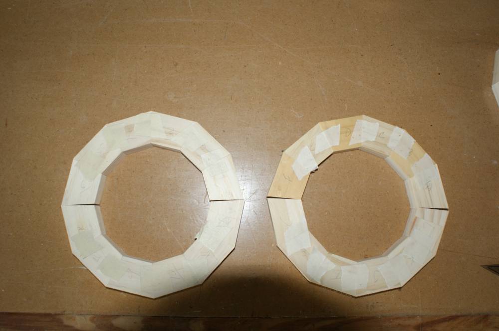

[ATTACH]27021[/ATTACH]
Looking at the above picture shows what happens when the angles are off. In the ring on the left the angle is too large ( over 15 deg) on the right the angle is too small (less than 15 deg)

- first sled.jpg (112.58 KiB) Viewed 8340 times
- left angle too large right too small.jpg (106.74 KiB) Viewed 8340 times
