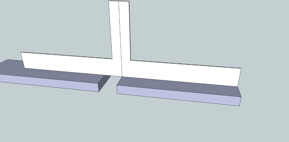

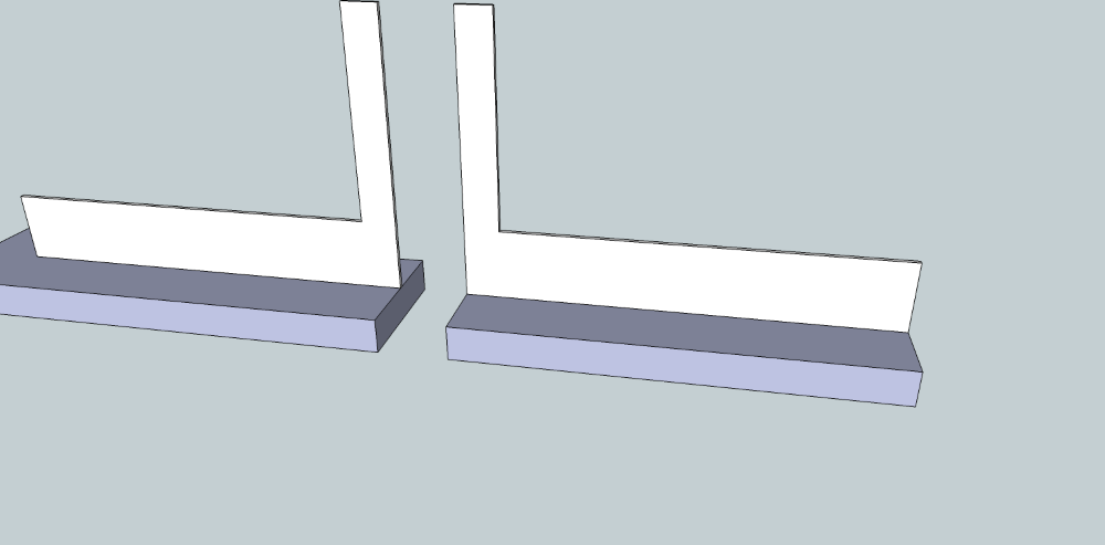

A couple of images that might help. These are intended to represent the jointer tables and two squares be used to verify the coplanar relationship of the two tables in a way that I had never thought of. This is a concept that was discussed in the links referenced by algale.
[ATTACH]26676[/ATTACH]
[ATTACH]26677[/ATTACH]
If the two squares come together with NO GAP, the tables are coplanar. This needs to be done at several locations across the width of the tables to verify the entire table set.

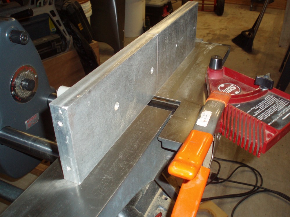

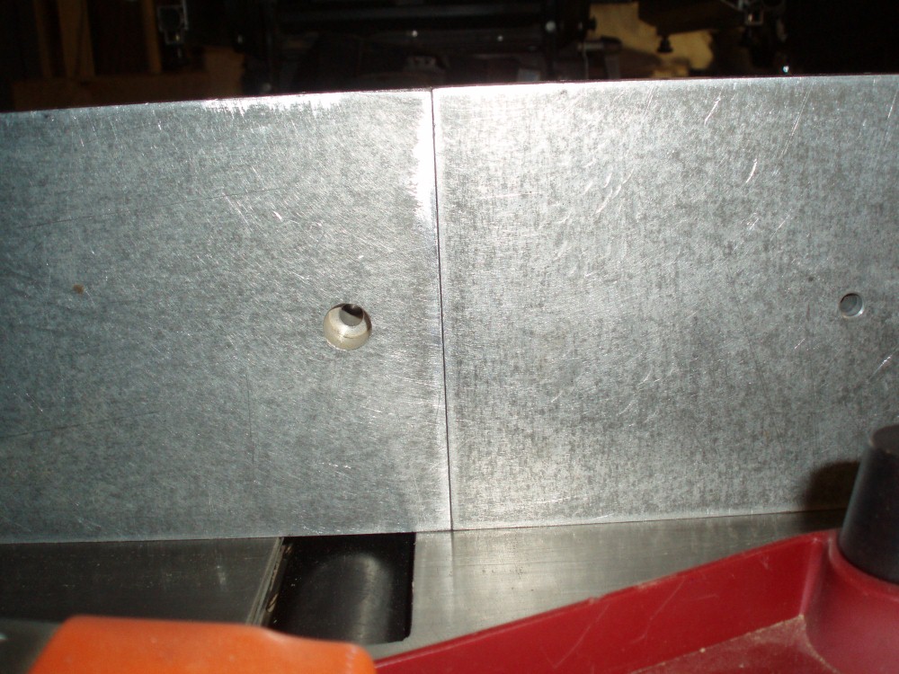

Making Wedges on the Jointer
I am fortunate to have some milled aluminum blocks that work perfectly for this task (tuning the jointer tables). In the absence of these, however, accurately cut wood blocks would do the same thing.
[ATTACH]26678[/ATTACH]
[ATTACH]26679[/ATTACH]
- Fine Tune the Jointer Tables 005 (Custom).jpg (212.33 KiB) Viewed 6076 times
- Fine Tune the Jointer Tables 008 (Custom).jpg (183.75 KiB) Viewed 6074 times
