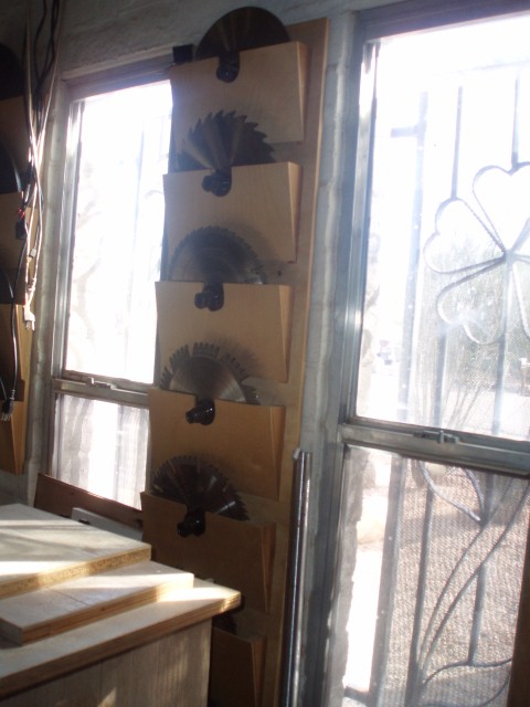

With sanding disks and blades, I have ten to store somewhere SAFE.
The attached photo shows how I chose to do that. Now I wish it held at least a couple more.

Thanks Dusty I think that setup would work the best in my shop. Also, I found out that arbor was NOT left hand thread. It was regular thread... The only thing I could think of was that it goes on the arbor opposite the quill. I plan to paint it bright orange so it's easy to tell apart from the rest.

If you make any of these, be aware that the sanding disk arbor is different than the saw arbors. It makes a little bit of difference in how the arbor cradles into the cutout. Also, leave adequate space between brackets. I consider mine to be too close together.thezman007 wrote:Thanks Dusty I think that setup would work the best in my shop. Also, I found out that arbor was NOT left hand thread. It was regular thread... The only thing I could think of was that it goes on the arbor opposite the quill. I plan to paint it bright orange so it's easy to tell apart from the rest.

Yeah I'm not sure it's official Shopsmith merch, but looks pretty similar. Also, about what angle are those pockets 15 degrees or so? Maybe mine should lean out a bit more to avoid jabbing my fingers on the blade above. Or is that what you're talking about?
