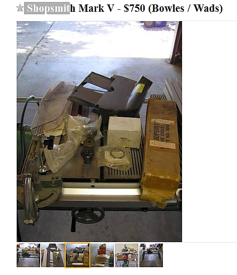

I'm looking at buying a used Shopsmith is there any certain years I should avoid? I can not afford a new one, but there are few used ones here in Denver, Co.

This un!
Old Greenie(with casters), but upgraded to a 520!!!
Check motor size. and drive train. 3/4---1 1/8hp and Gilmer---Poly v drive.
1 1/8 and Poly-v is best.
