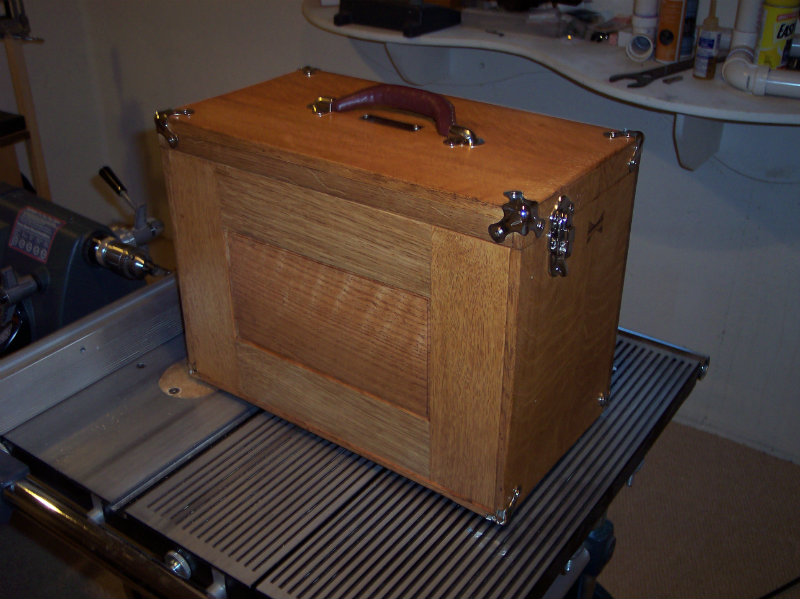

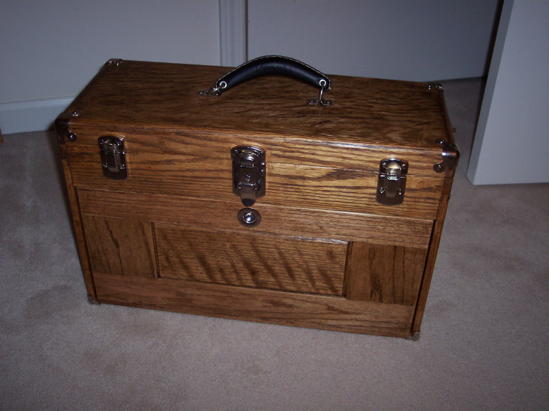

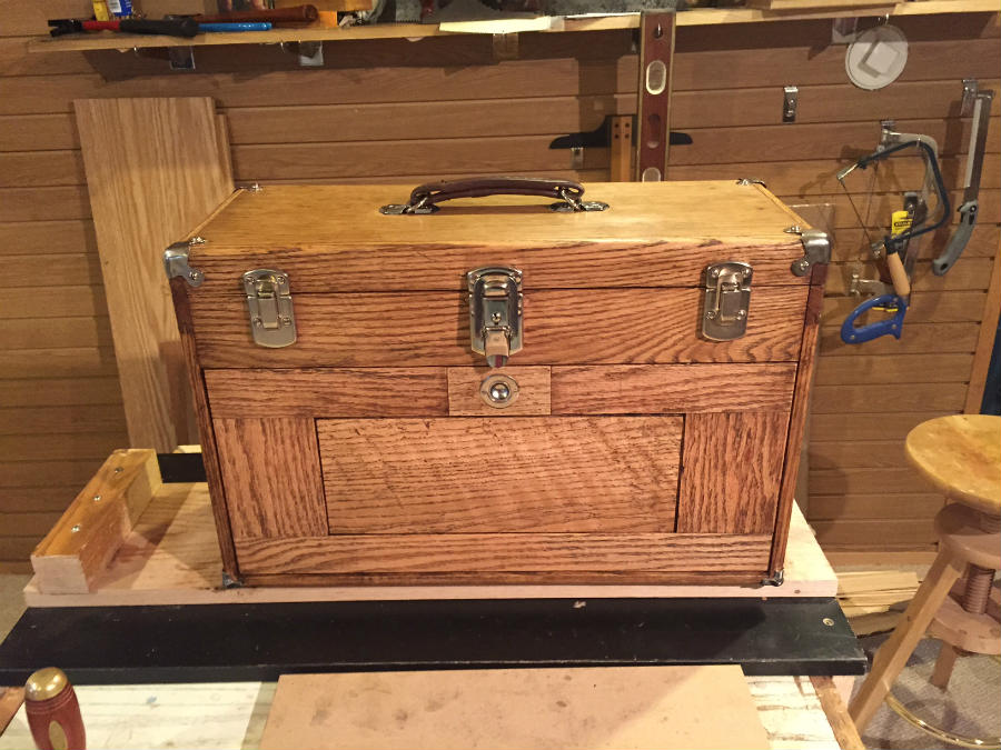

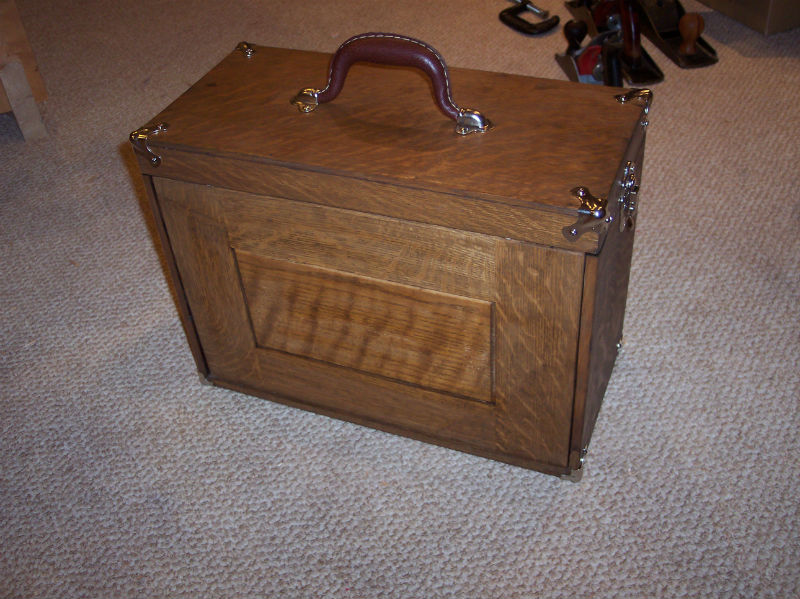

I'm working on another chest, now selecting woods for a new front panel. Here's some progress:
I love to talk about that center-panel wood choice. The same board I bought at ACE hardware about 4 years ago has yielded all the following panels. It was a beautiful figured piece of Red Oak just hidden in their pile of hardwood. The SS bandsaw has freed it to serve many!
Buttoned Up Chest.jpg (113.46 KiB) Viewed 3701 times
Chest for Kyle Closed.jpg (100.04 KiB) Viewed 3701 times

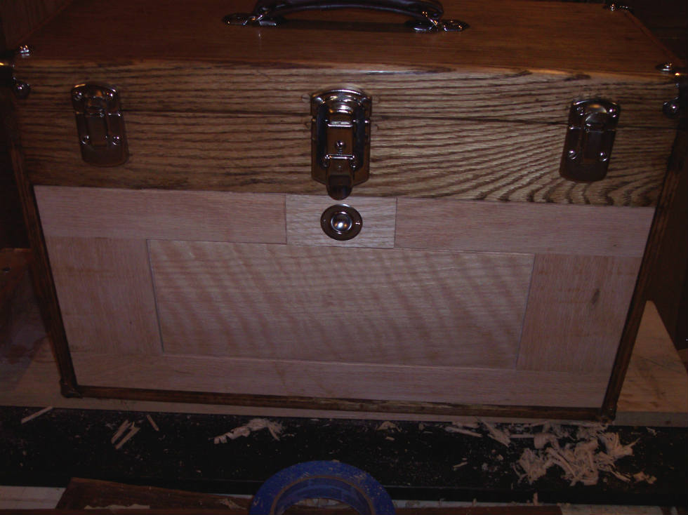

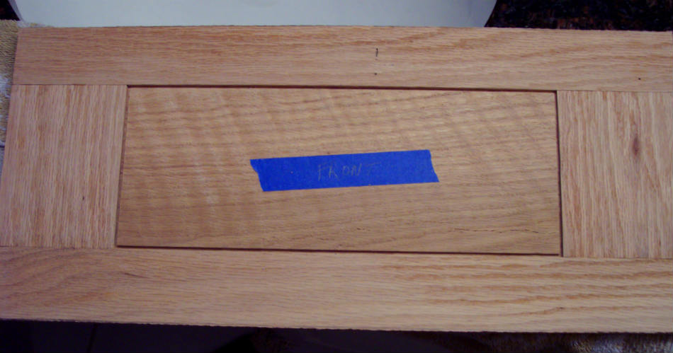

Fixing a Forstner Foul-Up
Post by nuhobby »
As work continues.....

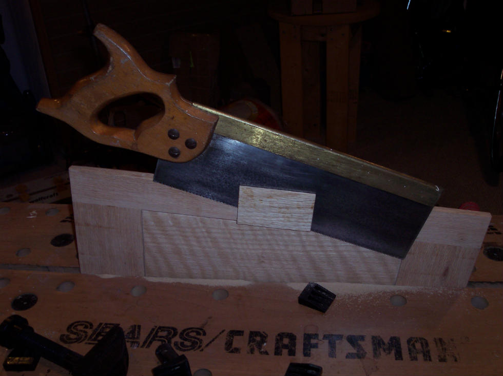

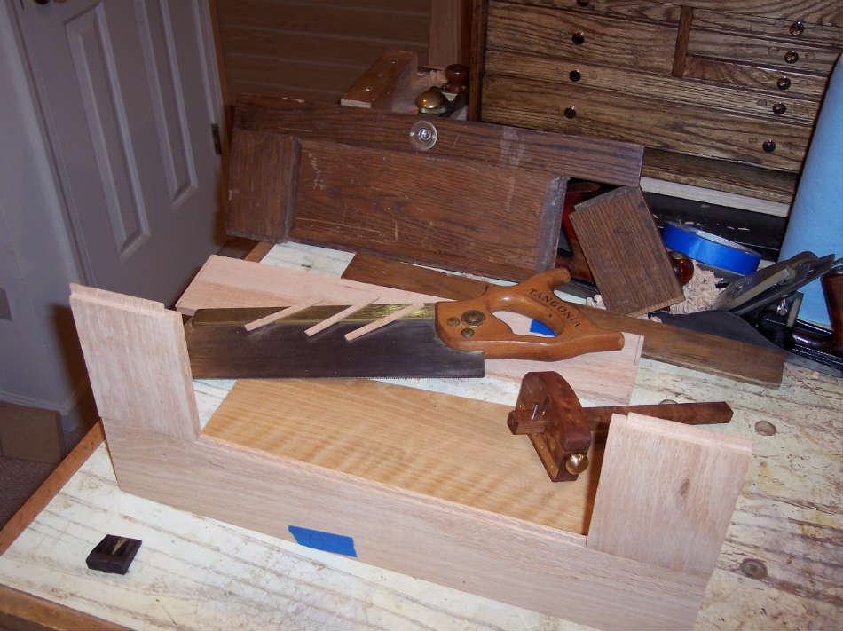

Here is the fit-up of the Frame and Panel. Note, there is a small "worm hole" about 1 inch to the right-of-center of the top frame piece. Only a FOOL would mistake that mark for the center of the panel...and that's what I did!
I had cut a 1-1/8"-diameter Forstner hole off-center. I first tried plugging the bad hole with a round patch-piece, which looked horrible. So I put a bigger rectangle patch centered over that whole area. Here I'm trimming away excess so I can plane it:
Finally, getting back to the intended result (as much as I can!)....

[quote="nuhobby"]As work continues.....
nuhobby do like I do and just blame it on the camera man! :D
Great job on those chest!

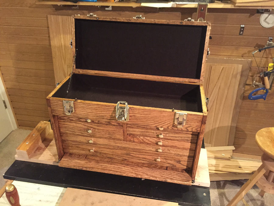

Here's a view on the inside -- this chest restoration is almost done! I went with the brown felt.
My wood finish isn't really suited for the garage, so it's more of a collector's chest than a machinist shop chest. It's just a light coat of Formby's wiping varnish, followed by dark brown wax to fill and tint the whole thing.
By the way, the whole restoration has been a bit of a lesson in wood and humidity effects! A long story on what all had failed from the original joinery, and what all I did about it. Just today I put in all the drawers to take the photo, and one drawer kept springing back at me! One of the side runners in the carcass was bowing out at the frontmost part. I shaved it down with a block plane...
