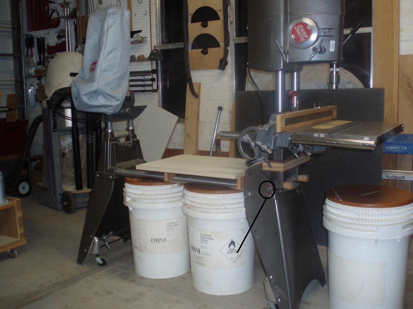

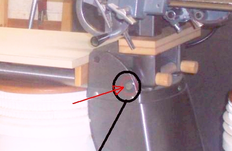

The vertical lock is nothing more than a bolt with a knurled head. We loosely refer to it as a lock but I never treat it as such.
It is circled in red and again in black in this image of my Shorty in the vertical position. Sorry to post something so hard to see. Lower right side of picture, very faint.
