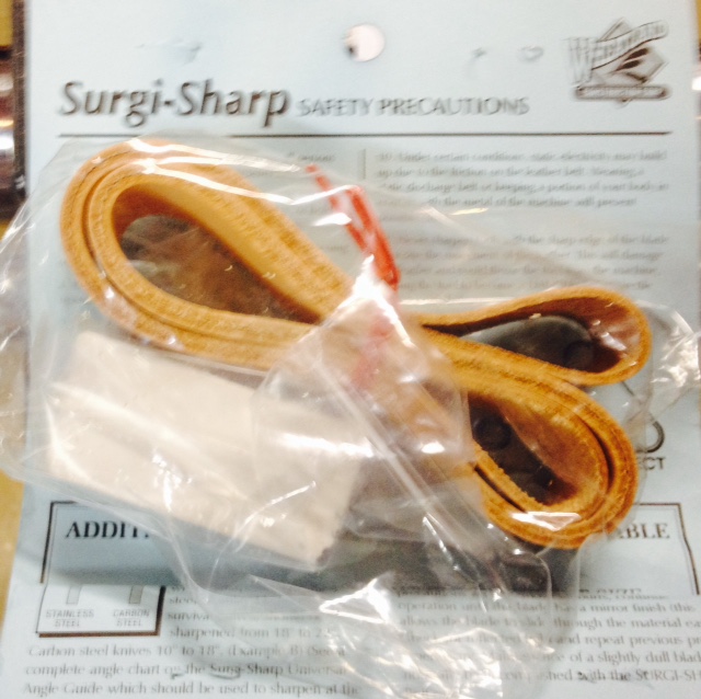

But I just achieved an even higher level of sharpness. To do that I purchased a leather strop for the Stip-Sander. The brand is Surgi-Sharp brand (website here http://www.surgisharp.com/index_files/Page392.htm) but I purchased mine off of Amazon.
There's nothing too exciting about they way it looks but here are a couple of photos of what you get.
The belt is initially a very tight fit (apparently to compensate for the fact that leather stretches). But I got it on the Strip Sander. Instructions specify rough side out.
While the belt may be boring to look at the results were terrific. After stropping, the bench chisels are capable of taking minutely thin shavings off of end grain Sapele.

Do you use a paste or compound to dress the belt?
Idaho Panhandle
algale
Posts: 4841
Re: Strip Sander Chisel Sharpening Attachment
Post by algale »
Yes, it comes with a small block of white (diamond?) compound. I applied it sparingly. The instructions say to apply it to the belt with the power off (turn by hand?). I admit I did add a touch more while under power.
