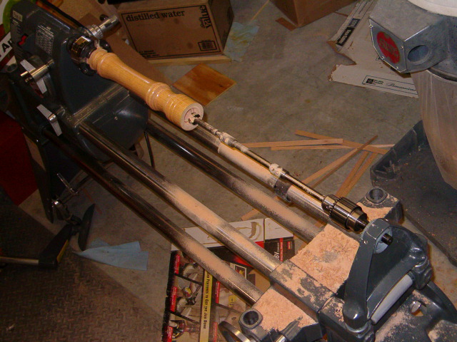

Like this. But in this case I had to drill 18" deep.ryanbp01 wrote:I was watching "The American Woodshop" on PBS this morning and Scott Phillips was using a Forstner bit to drill a hole into a blank held by a chuck. He advanced the bit by turning the ram on the tailstock into the blank while the chuck was stationary, What is the procedure to do this on the Shopsmith?

- drilling pepper grinder.jpg (131.7 KiB) Viewed 1255 times

Hind sight fer sure, but If I ever make something like that, I likely will turn the spigot on a square(at least two 'normal' edges) blank, drill the interior with the SS in horizontal boring mode, then make a plug for the tailstock end and do the spindle turning. Maybe a plug for the chuck end as well.
