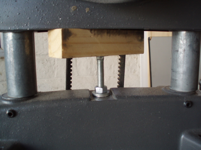

Bottle jack table lift
Charlese;
I now understand why you need a "real low" profile lift mechanism. I also understand why you would like to have some precision control over the height of the carriage (table).
I have attached a photo of the lift I use for the bandsaw. I use this to adjust belt tension but the same "principle" might work for the carriage in the drill press (OPR) mode.
Of course, it would require a much larger carriage bolt.
[ATTACH]1688[/ATTACH]
- Bandsaw Belt Tensioner.JPG (137.63 KiB) Viewed 8708 times
Hmmmm! Good idea Dusty! I'd like a faster movement - maybe like 5 or 6 threads per inch. Would likely require a hand made wood bolt or a vice screw. Thanks for the inspiration. Don't know that I'll get one of those round tuits soon, but will hang on to the idea!
