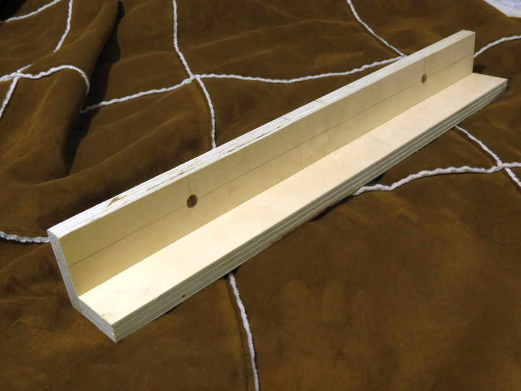

But I think you could also make a low-profile fence extension, perhaps 1/2" high, that fits underneath the saw guard. If you make it L-shaped, it would attach nicely to the T-slot on the side of your Pro fence. You might have to notch it out to clear the kickback pawl.
Re: rip fence; upper saw guard
Lots of operations require some fence attachments to make life easier. I'm not totally sure I understand how you are attempting to make the cut but since the "L" idea was mentioned I thought I would show you a picture of what one looks like, this one is for my 500 machines. I also have one for my 520 machines, basically just longer/taller. PTWFE has the plans if you have a copy of that.
