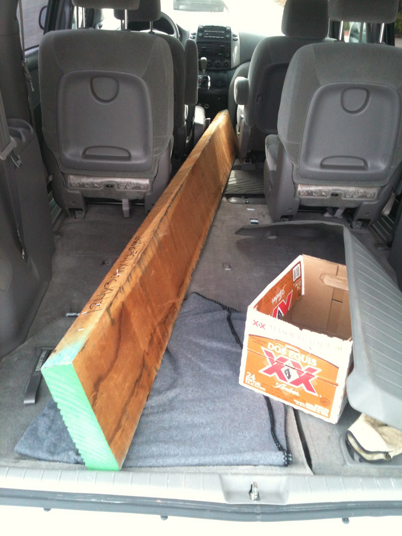

The oft talked about jointing technique for boards wider than your jointer really did work for me. I have part of a 10/4 rough cut cherry.
being brought home:
Bringing it home

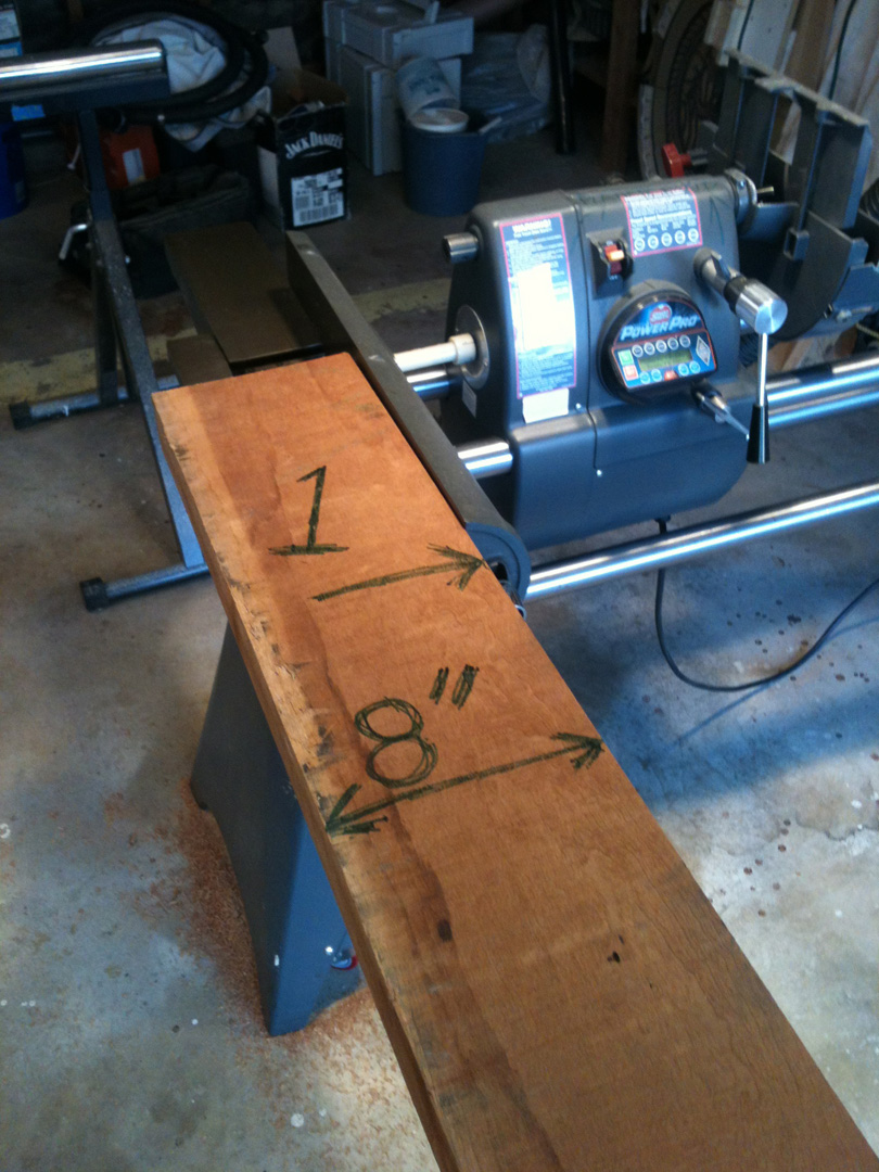

8" piece on the jointer:
8" one way

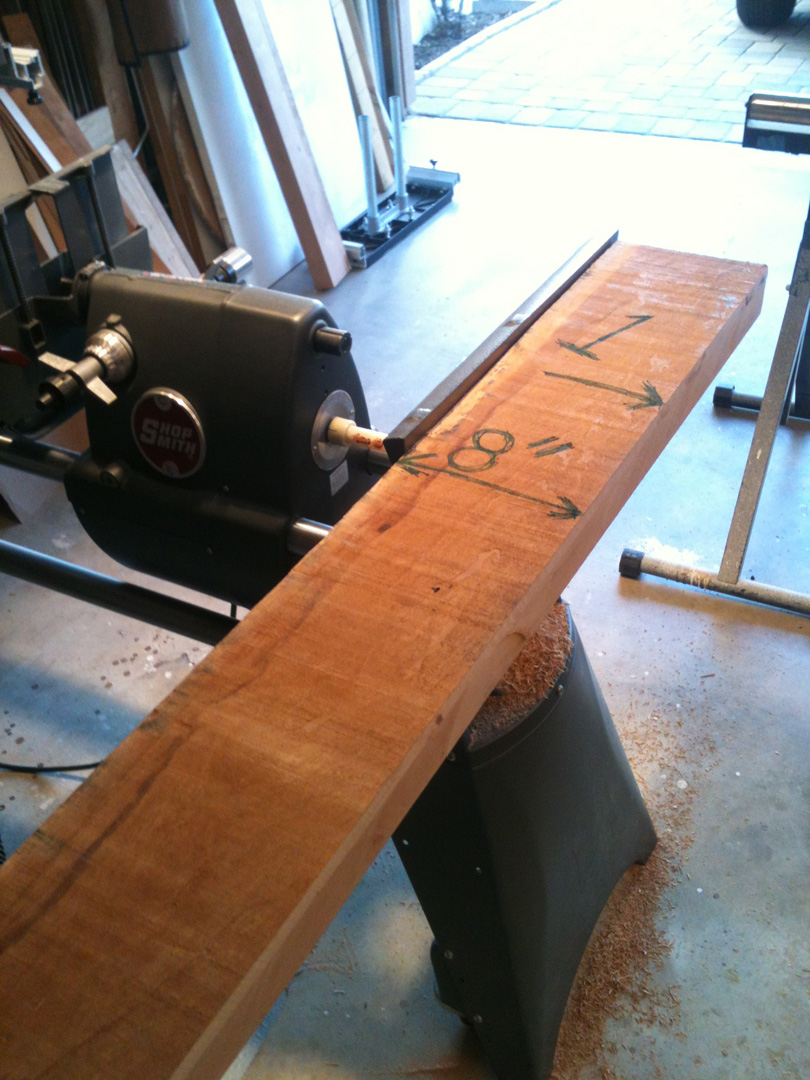

8* the other way
8* the other way
8 2.jpg (297.95 KiB) Viewed 3060 times
5" piece was done the same way.
I made about 5 passes alternating each end before I had a flat enough surface to run through the planer. When I got done, the two ends of each board (inside the minor snipes) were within 1/128 inch of each other.

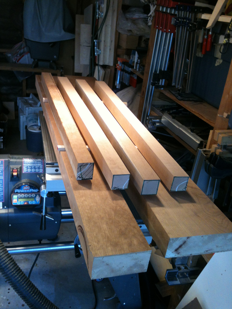

Final rough cut 'table' getting use to my shop:
resting
resting
Right now everything is around 6% moisture content and has not changed much in the last 3 days. I am going to give them a week before final milling.
