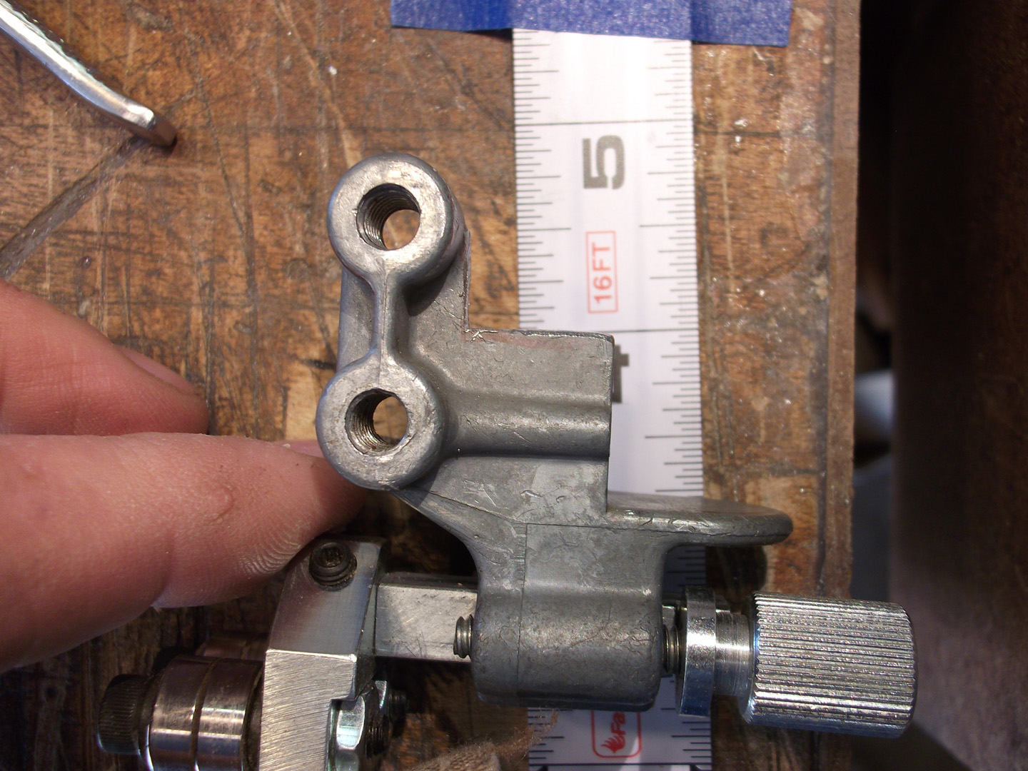

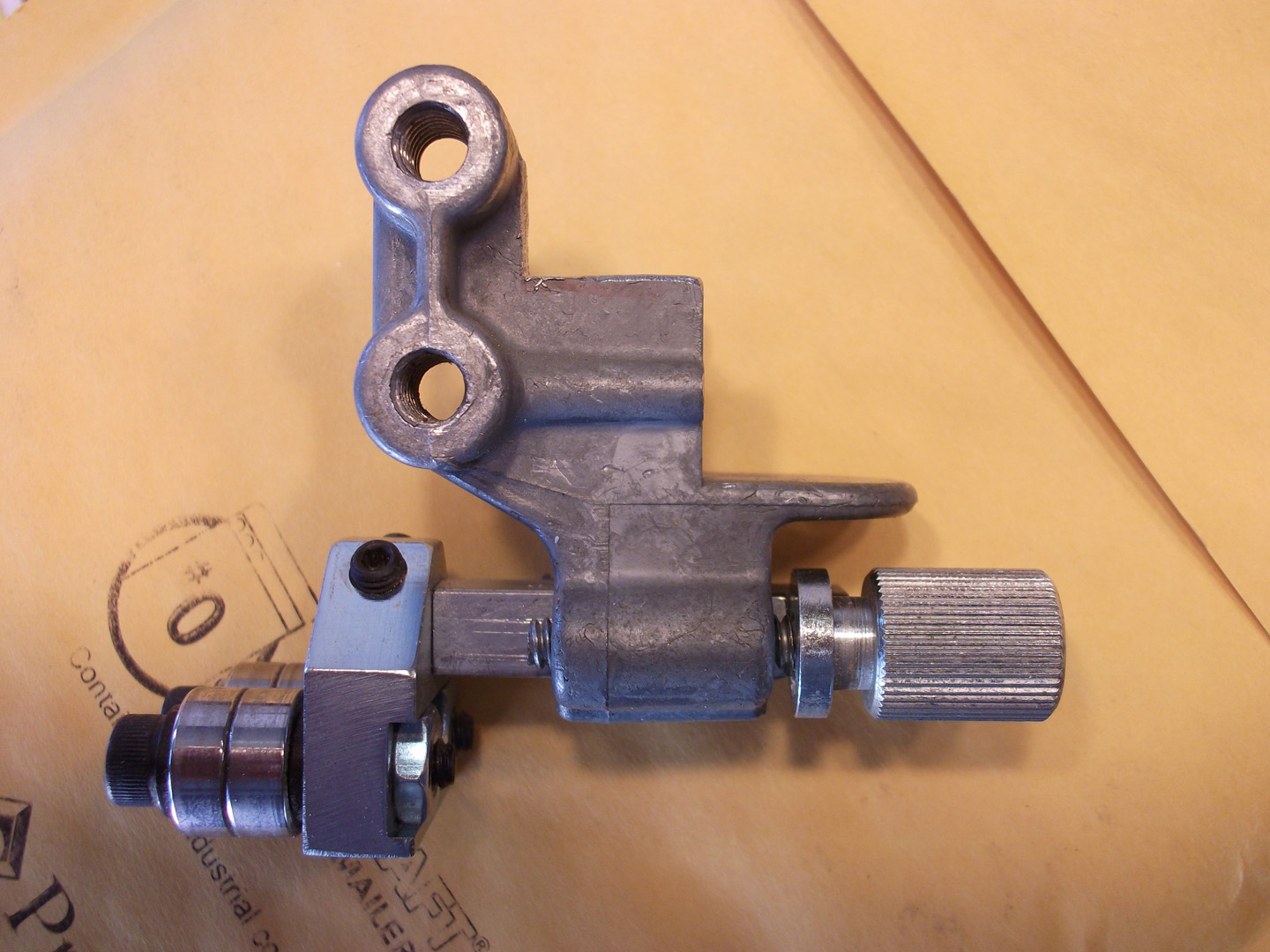

Someone had mentioned an SS Online video of how to widen that throat. I watched it (Drew Ackerman did the video) but it only gained a little bit - not enough for my needs. So I looked at my bandsaw and what Drew did to his and concluded (correctly, I hope) the he was being very conservative on his cuts.
So in the interest of the old Press On Regardless rally, I removed more material from my Upper Guide Bracket than did Drew in https://www.youtube.com/watch?v=2muM2mgnSZM.
Upper Guide Bracket Cut 01.jpg (337.31 KiB) Viewed 2501 times

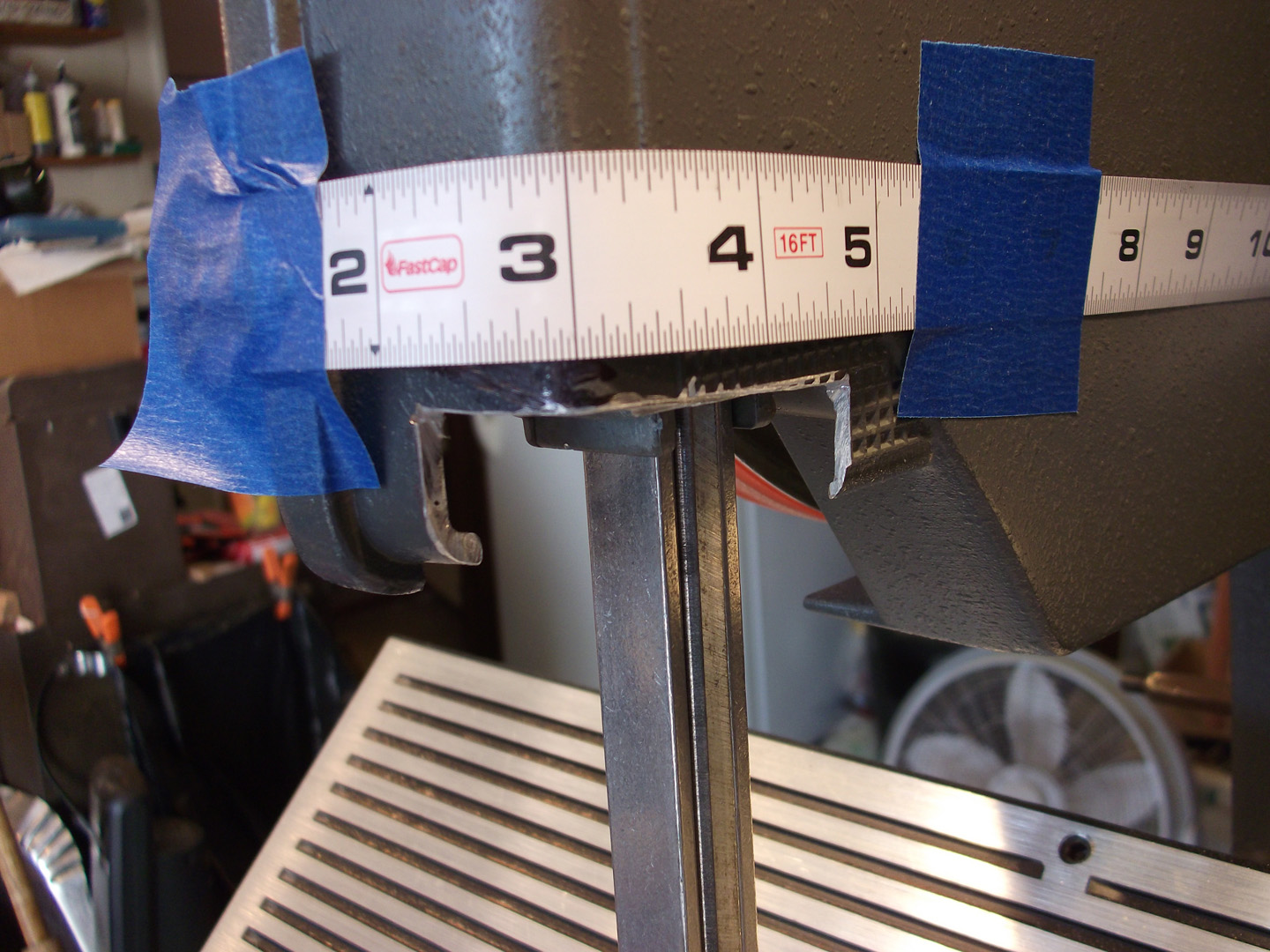

Time to check new throat clearance.
With the Carter Guides:
Throat Size Carter Guides.jpg (399.86 KiB) Viewed 2501 times

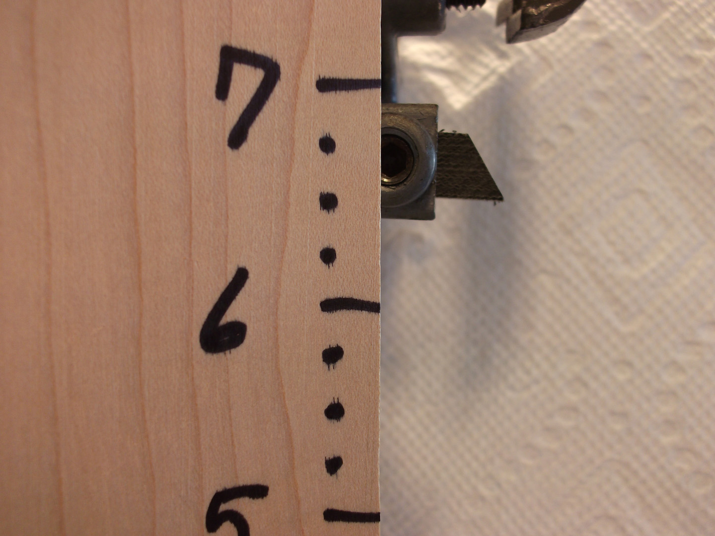

6 ⅛ inches was a good improvement, but not enough to allow final milling the boards to 6 inches. So I replaced the upper Carter Guide with the original SS Guide (with Cool Blocks) and got:
Throat Size SS Guides.jpg (288.64 KiB) Viewed 2501 times
I think that 6 ⅜ + inches will be good.

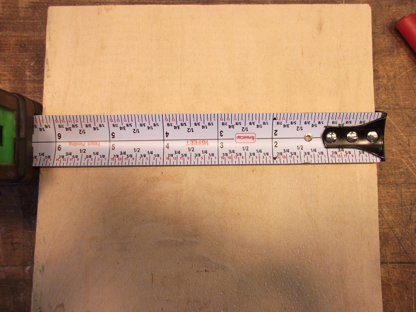

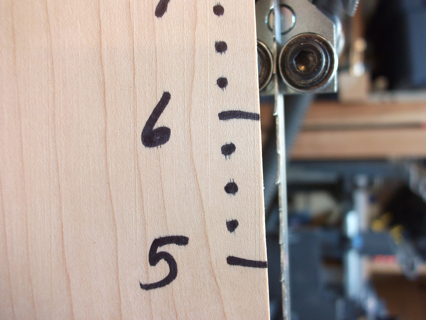

Best board wide I could get under the SS Upper Guide was 6 ¼ inches.
6 Board.jpg (498.65 KiB) Viewed 2484 times

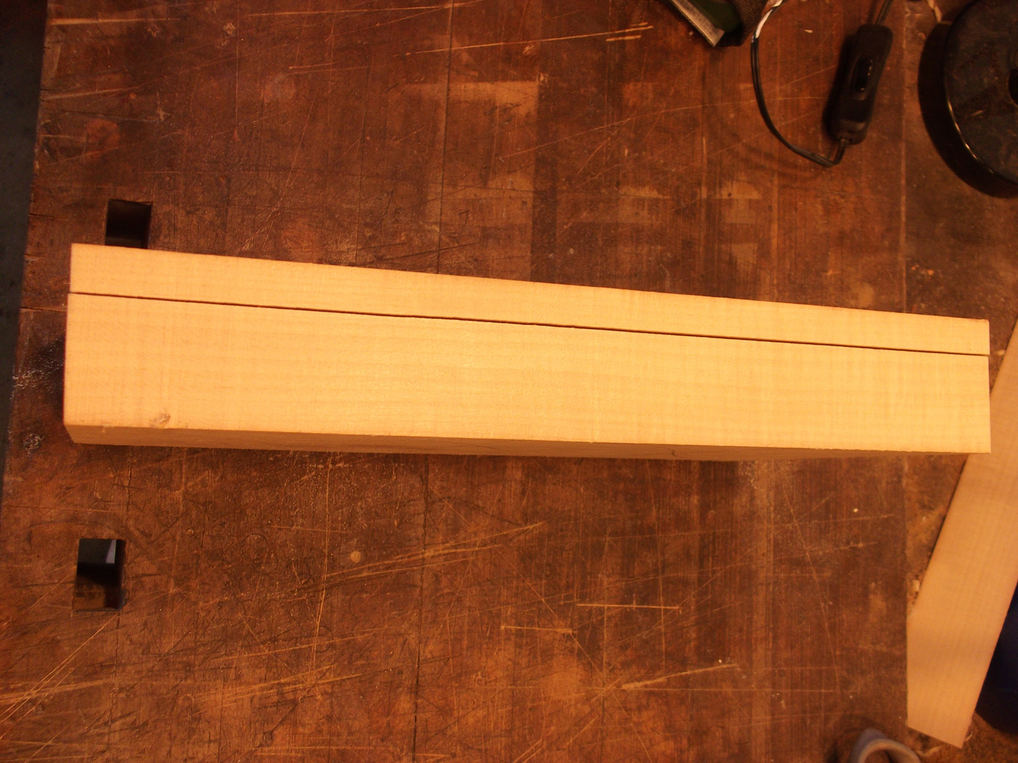

With that 6 ¼ inch board against a 90 degree fence set parallel to the blade - no drift compensation - the cut was as good as I expected. The ½ thick cutoff was very nice and straight end to end.
6 Board Cut.jpg (441.78 KiB) Viewed 2484 times
I think I'll keep this setup and prepare the 8 inch board down to 6 ¼.
Forrest
