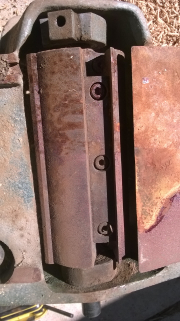

I just found out on this forum the shopsmith I was given is actually a clone of shopsmith. Wow... Well wondering sinch a clone of Shopsmith if the shopsmith jointer repair parts online will work with this. So I can replace with some shopsmith parts to get it running properly.
Semper Fi
Ted W
P.S. How the heck do you get the drum out of the jointer to clean it?

Re: Shopsmith Clone Jointer Repair (Shopsmith Parts?)
I think a clue is the two holes directly under the shaft. There is likely a screw there that holds the 'bearings?' in the casting. By backing them out,it MAY be possible to slide the head towards the drive shaft end and rock the far end in and up and out.
Unknown is what is actually in those holes and what lies underneath.
You be exploring unknown territory(unless Bill Mayo chimes in here).
Rust will be a problem as parts will not slide against each other easily.
We can discuss the blades/wedges etc. after it gets out and is 'derusted'.
I have only seen bolts in the holes, even on the clone 6" joiner. The cutter head comes out through the top (table side) hole.

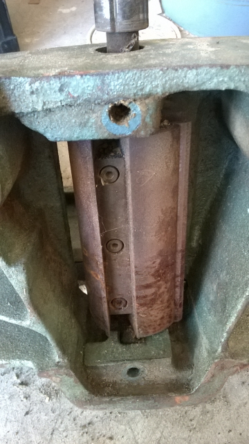

Ok, the drum moves freely and not clamped down after removing thw screws that held the brackets and the drum in place.Problem encountering now is the whole assembly does not seem to be able to clear the end edges where the once bolted down brackets were when trying to pull it out, even if trying to lift from end without shaft to angle the drum out so end with shaft can be pulled out. Do I need to remove all the blades and the clamps holding the blades to get the rest of the drum out (First?). Seems the 2 end pieces after they have been unscrewed do not allow enough clearence to pull out since the shaft sticks so far out and does not allow enough of a rise to get a bracket clear of planner side..
DIFFIDENTLY take the knives out.
You have reached the point I alluded to a few posts back. I think the bearings need to slide towards the cutter so the blocks clear.
