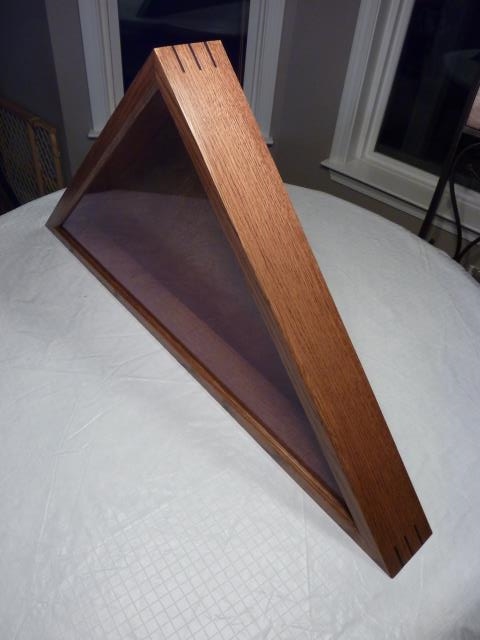

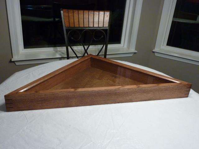

Mission Accomplished!!!
Thanks guys for all the tips. I couldn't have done it without you. Well, ok, I could and would have but with much more frustration. :rolleyes:
Does the jig look familiar Bill? I also made a sled for cutting the splines.
Used white oak with special walnut stain, walnut for the splines. The museum glass was $85.
Customer is very satisfied. They were going to refold the flag and try to minimize the wrinkles. Presentation is tomorrow and she'll be in the museum next week.
Thanks again. This forum is a great resource!
