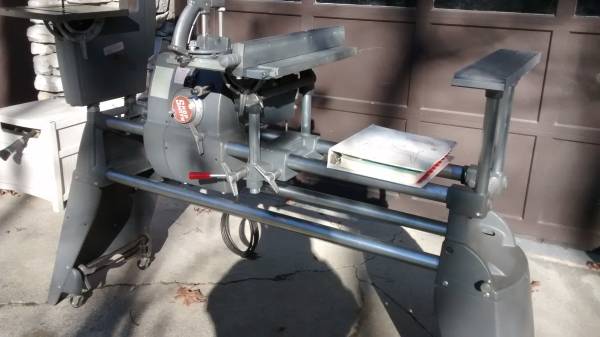

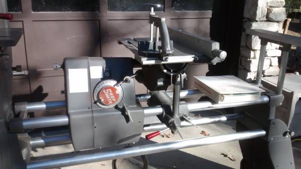

Would anyone be able to give me some advice on what would be a good price for the pictured unit with the basics plus a bandsaw?
I am excited to get to work with ShopSmith but I don't want to make a mistake, (money saved can be applied to unforseen maintenance issues and future upgrades etc).

2hp? NO! (Well a powerpro @ 240v, but not THIS) First off ask the guy if he knows what model it is? If he says Mark V, well then the guy doesn't know what he's talking about. It's an older Model 500, but does look to be in really good shape. Yeah, maybe $300-500, the bandsaw might add $50-100. I don't see any of the accessories. Make sure most of the accessories are there, ie saw blades/arbors, drill chuck, lathe tools, sanding disc, ect. See if you can plug it in and run the speed dial up and then back down. How much are they asking??

Re: 2hp shopsmith?
Just to keep terminology 'correct', That appears to be a Mark V 500 made by Shopsmith, Inc.. If from the 70's it may be a Mark 5 also from Shopsmith. Inc..
The vent plate will 'tell the tale'. Regardless, it is the same collection of parts. ;)
The vent plate will also say, 1 1/8 HP. :cool:
