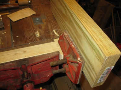

I'll post this picture now then when I get a chance later this evening I'll post some more with an explanation. Don't hold your breath until then, most bird houses are more exciting. :)
Guess what.jpg (96.5 KiB) Viewed 2660 times

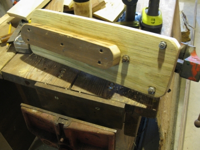

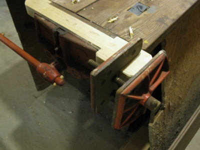

Here is the Reed vise.
Vise mount 2R.jpg (109.81 KiB) Viewed 2620 times

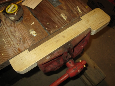

Here is the adapter mounted in the vise.
Vise mount 3R.jpg (102.21 KiB) Viewed 2620 times

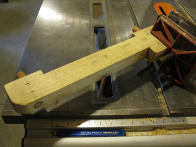

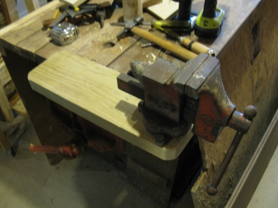

I do sometimes want to support a board on edge at the left end of the bench. I have this cute little cast iron vise that we used to have mounted to a sawhorse for remodeling jobs.
Vise mount 4R.jpg (94.67 KiB) Viewed 2620 times

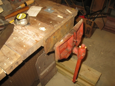

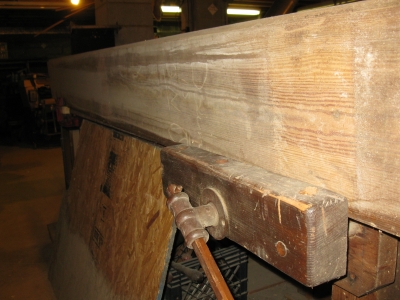

With it in this position I can clamp a long board (I often work with longer boards) upright in a vise at both ends of the bench at once.
Vise mount 5R.jpg (101.2 KiB) Viewed 2620 times

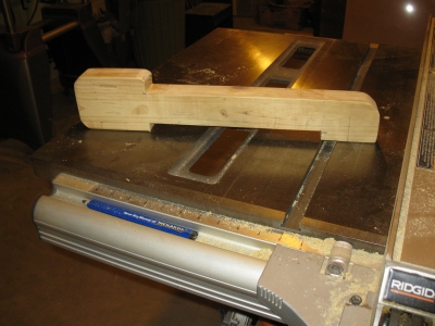

On the odd occasion that I want to work a board on edge up on the bench I can move the small vise a couple of inches to the left so the board rest on the bench top. Most of the time it will just hang under the bench.
Vise mount 6R.jpg (106.7 KiB) Viewed 2620 times

I had thought about this to start with but didn't really think that it was necessary. Turns out that it is. With the heavy little cast iron wood vise hanging out on one end it can take a bit of effort to line the mount up with the big vise and have a hand free to tighten the big vise. So I went with my original plan and put a couple of dowels in to go into a pair of holes in the end of the bench that line the mount up properly so it supports itself taking care of the weight all being out on one end. Can you tell that I have just been messing around lately? :rolleyes:
Then I couldn't find my dowel centers... Still in a box someplace. :confused: Rather than measure and screw it up :rolleyes: I just clamped the mount in the vise and drilled all the way through the mount and into the bench. That way it "had" to be right. I'm sure the two dowels glued all of the way through the mount makes it stronger but then again I am also sure that it didn't need to be any stronger. :)
Anyway, it works just great.

When my woodshop was still in the farm shop if I wanted to bend a little piece of steel for something I just walked a few more steps and used one of the 5 or so larger metal working vises at several locations there or if I wanted to beat the crap out of something I could use the big anvil in the blacksmith shop. Several times since I move the woodshop to the basement I have wanted a regular vise to bend something or even just to hold a tool differently for sharpening. I have had the little vise in the picture for a long time and used to keep it on a smallish bench in our store. I "think" it was on a bench I got at an auction but I can't remember for sure.
Since I was on a roll I grabbed a couple of pieces of scrap and made this mount for the little vise. I expect it to get a reasonable amount of use.
Now I need to unmount the vises and clean them up well and paint them and also paint the mounts because if I don't do it now I may never get back to it.
