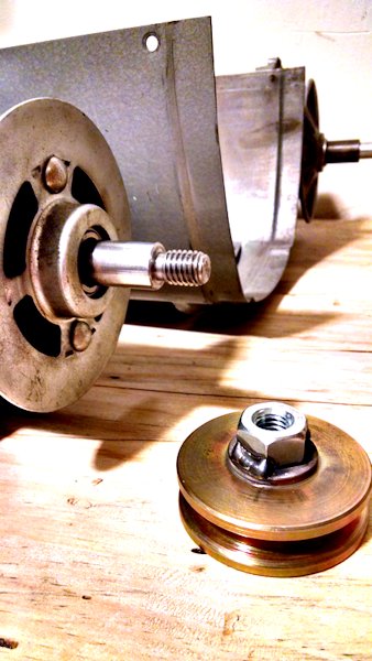

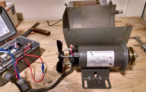

OK, I have a 2HP dc motor with speed control and reverse that I want to put in my greenie. Only problem is it has a pulley for a narrower 3/8" belt. I can't easily swap the pulley because the PO spot welded the pulley to a lock nut instead of cutting a keyway in the shaft. He didn't weld to the shaft, so I can swap it, just hope not to have to.
I can't think of any reason not to use a narrower belt AS LONG AS the stock speed control is disabled and the sheaves are locked in a position where the belt can't get jammed in.

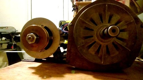

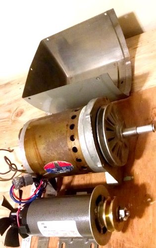

Will that motor physically fit in a Greenie?
Re: 3/8" link belt on sheeves if they aren't moved? (DC motor)
You will need to disable or lock the control sheave or replace it with a fixed single steel pulley if you are using a DC motor. I was never able to attach a sliding spring loaded set of pulleys on any DC motor or see the need to. I replaced the speed control assembly parts with a pot and tack welded the speed control dial to the speed control handle so I could see how to vary the DC motor speed. A DPDT switch was added for the reverse operation. I used a 1/2" aluminum plate on the bottom of the headstock using the same mounting setup that the PowerPro motor uses and attached the DC motor to the plate so I could adjust the belt tension. I operated with a 1/2" Link belt for many years in both directions with no problems since I was using steel pulleys. I found I had to switch to higher HP 180 VDC motor and 220 VDC controller from the 90 VDC motor and 110 VDC controller to have the low end torque I needed. This was a very smooth and quiet operating headstock. I still have some of the DC motors and controllers left over from this time of playing with variable speed motors. The PowerPro was a better solution so I gave up on placing DC and 3 phase motors in a Shopsmith headstock at that time. I could not find any customers for my converted Mark Vs with these motors so I converted them back to the original motors.

Chris - yes, it fits. Sorta. Smaller diameter than stock but a little longer with the attached fan on the back, though I can shorten that end of the shaft (it is oddly long). That way I'll just make a louvered extension on the motor pan that sticks out around an inch - won't interfere with anything. Bill! I'm always glad to get your input!

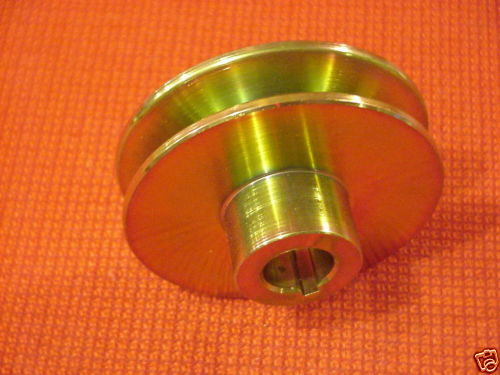

Turned out the pulley isn't appropriate as is.
It is spot welded to the nut so that it doesn't turn, but there is nothing to keep the nut (and pulley) from spinning off when run in reverse (which is the normal way for SS, as this motor runs the other way stock). The shaft is .67" or 17mm, luckily standard for alternator shafts, though there is no keyway etc. I just purchased a replacement: . I'll be able to drill and tap it for a set screw and grind a flat on the shaft. I can also grind a slot in the shaft for a key though I hope to not have to bother. I also got a stop collar, thinking I would just use a key and capture it between the stop collar and the nut, though I'd like a simple set screw instead. I also checked the minimum pulley diameter for A size link belts and this is it: 3.1something. The other was too small, and 3/8 instead of 1/2 wide belt. I figure I'll start with HF purchased link belt to get it all set up, then switch when I know the size so I can conveniently use reverse.
I love the idea of using the control knob with the electronic speed control's pot. I plan on adding a tach, something that it doesn't have.
It also needs the reverse switch. I've tested it, just needs a switch. I saw a post somewhere else (don't know where, argh!) in which they had a safety toggle switch that didn't allow going from forward to reverse or vice-versa in one movement. You had to put it in the central OFF position then move it again. So far I can't find one, probably because I don't know what terminology to use in searching for switching. DPDT I know but only because I looked it up last week.
I have no sense of whether this will provide enough torque. Hope so, but I'll find another use for it for sure if it doesn't. I got it off craigslist for $120. I had looked at salvaging a treadmill motor myself, only that was just low enough a price that I thought it worth it: means not having yet another big collection of parts of something in the house to drive SWMNBPOTOOILMT* to distraction. He's been messing around with them for a while, it seems, and did a great job overall - though I'm changing a couple things. He shipped it super fast and has answered a number of questions I had along the way.

- Motors.jpg (34.62 KiB) Viewed 1711 times
- Notice how far the shaft for the fan extends? Why? maybe to clear the ridiculously long bolts! All can be trimmed.
- Motors-Fan.jpg (39.15 KiB) Viewed 1711 times
