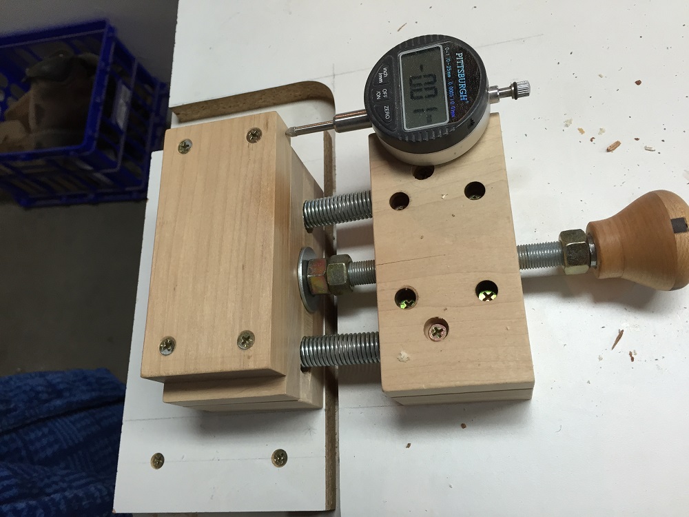

I think my micro-adjuster can be used for other applications as well. I don't know what just yet other than maybe for a router edge guide or even portable circular saw edge guide.

Here is some more ideas to ponder. If you spring load the adjuster it will make it a little easier to hold the setting while you make minor adjustments and clamp it in place.

masonsailor2 wrote:Here is some more ideas to ponder. If you spring load the adjuster it will make it a little easier to hold the setting while you make minor adjustments and clamp it in place.
Paul

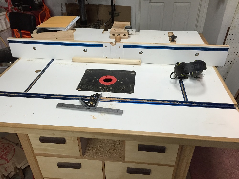

Thanks, Paul. I like your table set up; it has a crisp, clean and professional look. I especially like your adjuster rig! Everything but the hardware is handmade (presumably by you) down to the knob on the main screw - nice! My adjuster is spring loaded, but I'm using compression springs on external posts. It looks like you have extension springs rigged internally; I hadn't thought of that. It makes the unit much cleaner. I noticed you used hardwood - is it maple? I have some reclaimed pallet hardwoods, some rescued from the dumpster mahogany cut offs, and some cherry sitting in the shop while I ponder what to make with it. Maybe I'll make my final out of some of that pallet wood - I think some is either ash or maple. Another thing I noticed and hadn't thought of is the dial guage. I was thinking linear scales on tape or metal, but wasn't sure how to mount it. I think I will add a mount to use my dial guage (which sits nearly forgotten in a cabinet).

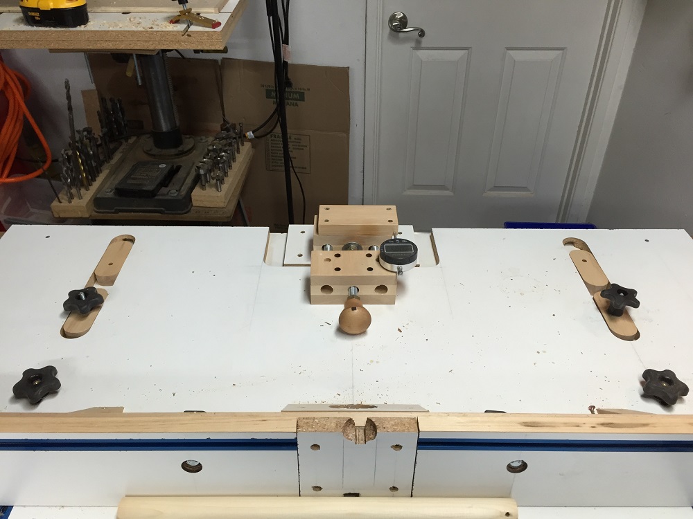

Yes I made it out of maple and the knob is turned on the SS. I put a crosshatch in the middle of the knob with a darker wood to be enable to judge the movement of the knob better. 1/4 turn, 1/2 turn etc. The fence is a two level design which are indexed to each other and then the lower unit is indexed to the table both by miter slots. There are two sets of clamping knobs. This allows you to do quick gross movement of both layers such as retracting the fence for bit change . Once the bottom layer is clamped down the top layer which has the fence attached can be fine adjusted with the adjustment unit. This also allows for quick removal of the entire unit leaving an unobstructed table top for routering large freehand pieces. For the adjustment screw I used a fine thread 1/2 " stud I cut from a piece of all thread. I have tried using standard coarse threads in the past and it did not give me the control I needed.
