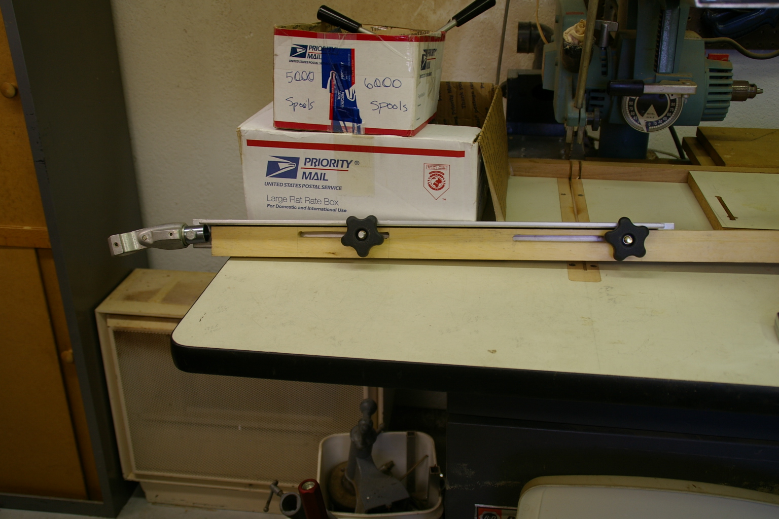

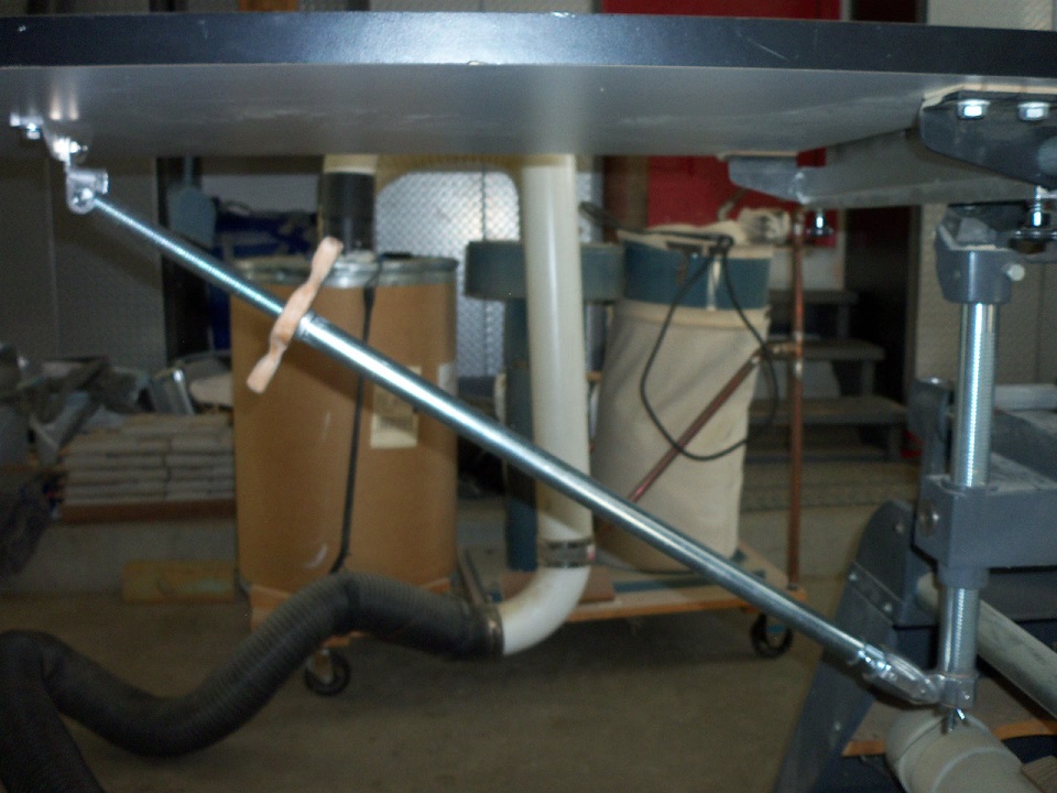

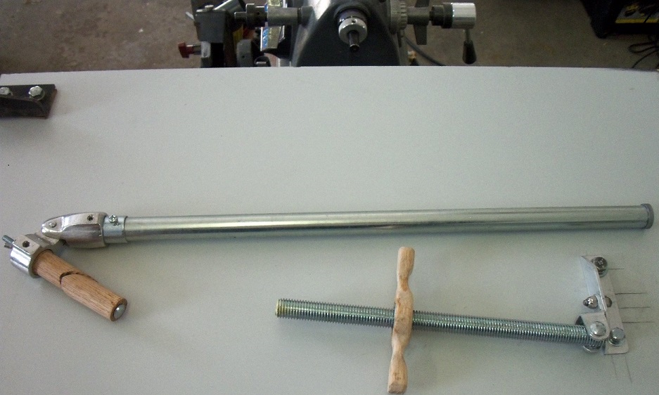

I have just finished part 1 of my upgrade to my table extension. I used the plans in Sawdust Session #20 with one change. I did not use the the telescoping leg as directed, I used 1 inch electrical conduit with a inline connector that fitted into the coupler (removed one screw and filed it smooth), a rigid to flexible connector Note the inside diameter is the same as the 3/4 rod. (I cut the threads off and filed off the nibs so it slid into the conduit), and a 3/4 x 12 inch long threaded rod with nut. This is a very stable extension that adjusts with the table. See attached pictures.

Nice mods!macgyver wrote:I have just finished part 1 of my upgrade to my table extension. I used the plans in Sawdust Session #20 with one change. I did not use the the telescoping leg as directed, I used 1 inch electrical conduit with a inline connector that fitted into the coupler (removed one screw and filed it smooth), a rigid to flexible connector Note the inside diameter is the same as the 3/4 rod. (I cut the threads off and filed off the nibs so it slid into the conduit), and a 3/4 x 12 inch long threaded rod with nut. This is a very stable extension that adjusts with the table. See attached pictures.
I have a home made outfeed table that also uses the 1" EMT conduit between the main table lower post and the outfeed table for support your modifications are definite improvements.
