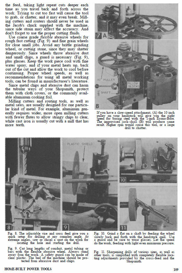

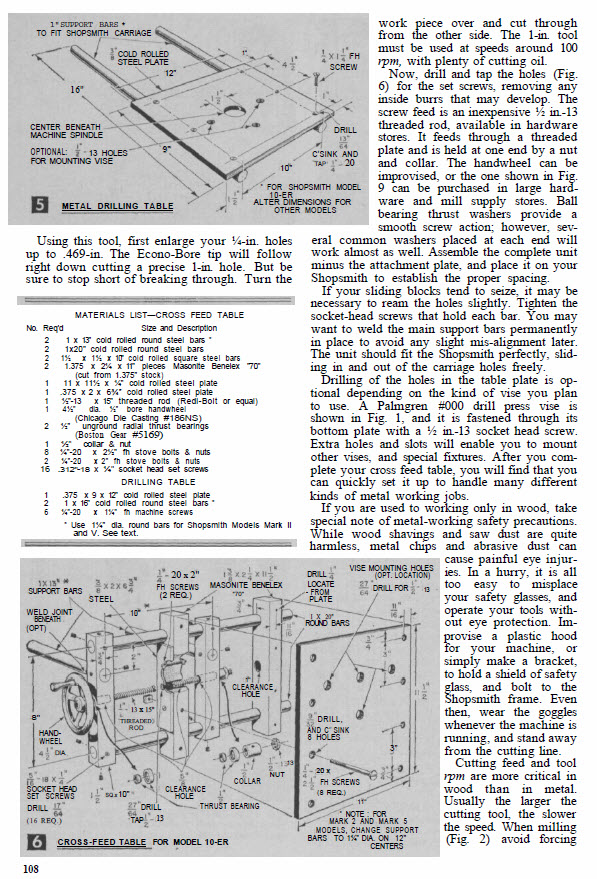

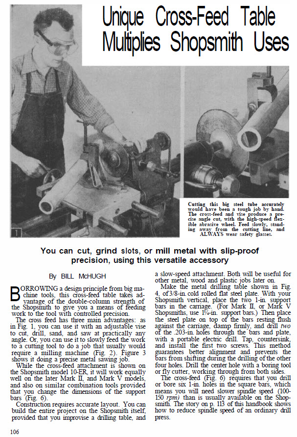

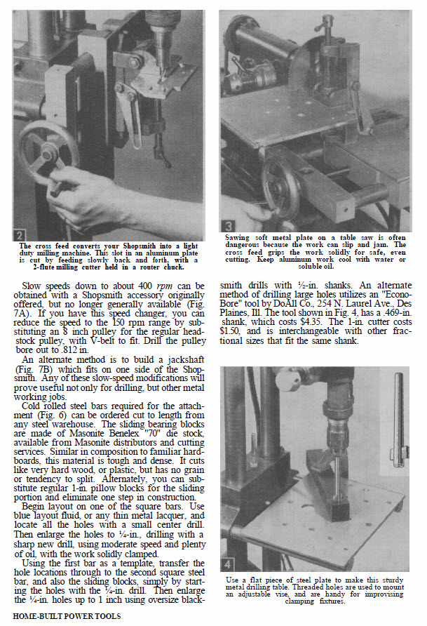

Kinda late reading this post, but here is more on cross-slides:
4-1-2015 11-00-56 AM.jpg (332.77 KiB) Viewed 8155 times
4-1-2015 11-02-07 AM.jpg (313.7 KiB) Viewed 8155 times
4-1-2015 11-02-41 AM.jpg (386.83 KiB) Viewed 8155 times
4-1-2015 11-03-16 AM.jpg (285.49 KiB) Viewed 8155 times
Might be some mounting ideas.....I'd like to build one of these!
If anyone needs a pdf of this article, send me your email addy to pmerriam at eastlink.ca.
