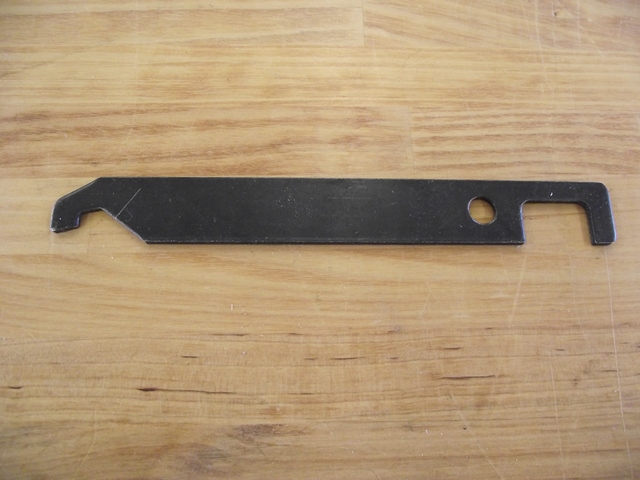

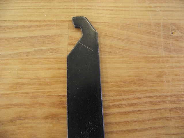

I ordered a new planer setting gauge as I could not find the one that came with my father's planer. The new one looks like the one Nick uses on the video, not like the curved one shown in the original manual. I assume that the only way to make this one work is to put a masking tape pointer on the gauge and eyeball the clearance with the blades as Nick explained. I think something far less crude is warranted, but because I have the SS table, I cannot use a magnetic base with dial indicator. Are any of the setting tools that actually clamp to the cutterhead recommended? Thanks for the help, Glenn

The SS planer knife setting gauge works fine in my experience. I don't know why you say the owners manual doesn't tell you how to use the gauge. Mine certainly does as does the one on the Vintage Machinery site that rcplaneguy posted a link to. I think your blades are way to narrow and the only source is SS. Even then you will need to use the setting gauge.
