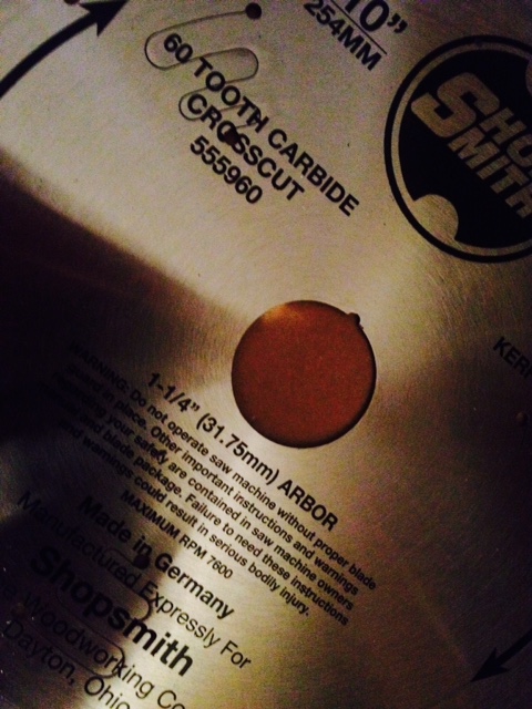

This isn't a review per se, I'm just passing on some info and asking some questions about my recently acquired Shopsmith table saw blades and arbors.
1. I'm not making any judgment good or bad about this, just passing on information, but the 1 1/4 blade arbors are currently Made in Taiwan according to the packaging. Maybe this has been the case for a while, I'm not sure. On an initial exam, the arbors don't look or feel any different from the only other 1 1/4 arbor I own, but since I acquired that arbor second hand with my circa 2001 520 I don't know where that arbor was made, although I have assumed it was made in the USA given its vintage.
2. The new table saw blades, which I knew were made in Germany, are listed as 0.098" kerf on the package. So the kerf is actually somewhere between a 1/8th" (0.125")standard kerf and a 3/32nd" (0.9375") thin kerf. My guess is that, as these are made in Germany, the kerf probably is really 0.25MM which works out to 0.098424 inches.
3. The maximum speed for these table saw blades is listed at a whopping 7600 RPM!! Are there any table saw operations that would call for such a high speed? Even if there were, the max speed of my non-Power Pro headstock is "only" 5200 RPM so I guess I won't be running these blades up their top speed any time soon.
4. For reasons I cannot discern,all three saw blades have a tiny, semicircular cut out on the circumference of the 1 1/4 arbor hole, almost like it was designed to be used on a keyed shaft of some sort, as seen in this photo:
I probably won't write a performance review of these blades for a while as most saw blades cut quite well when new and I want to see how these hold up.

Those slots are for heat expansion and/or vibration/resonance reduction.
See the part on the laser cut here: http://www.dewalt.com/featured-articles ... means.aspx
Roy

algale wrote: 4. For reasons I cannot discern,all three saw blades have a tiny, semicircular cut out on the circumference of the 1 1/4 arbor hole, almost like it was designed to be used on a keyed shaft of some sort.
I suspect it is used to provide indexing during manufacturing, which is no doubt automated and computerized.
